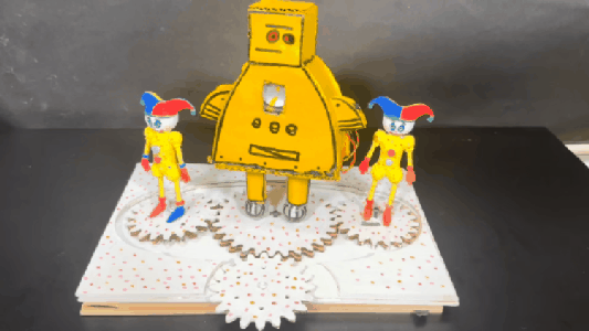

This is the Instructables Mechanical Birthday Cake!
This project involves a four-component gear mechanism, with two 3D printed colorful characters, one cardboard painted instructables bot, with a bluetooth speaker within its body and a handful of acrylic paint and marker to illustrate the birthday design.
I will take you through the process of how this mechanical cake works and how you can create and customize your own version of a mechanical cake
This Mechanical Birthday Cake is going to be cut with the instructables bot and his fellow friends in the Instructables 20th Birthday party

Step 1: Lasercut MDF Gear Base
I will take you through the step by step process to get this machine ready and the boards cut:
  1. Download the xTool Creative Space application
  2. Connect your laptop or device with the application to the xTool machine
  3. At the top right of the application there will be 2 arrows pointing in opposite directions, click on that to add/switch your device
Get your 3 MDF boards ready and start to design the shape of your project within the xTool application;
  1. With the 40cm x 20cm MDF Boards you can think of a gear design that would fit: The gear design used in the project above consisted of a 1x 30 teeth gears and 2x 20 teeth gears.
  2. Files of 20 Teeth gear, and 30 Teeth gear are linked below
  3. Construct a suitable design to your MDF size and click the "Cut" option on the right side of the application
  4. Make sure MDF board is correctly positioned in the machine to where you want your design to be, this can be done through the top right "camera" icon which allows the machine to capture a photo of the MDF's position overlayed with the design you have created
Prepare to start cutting with the machine by following certain safety procedures
  1. Once printing starts, the lid of the machine must be closed at all times to prevent any dust or heat being exposed outside
  2. Make sure the exhaust hose at the back of the machine is also running which circulates the smoke being exposed from the laser
  3. Finally, press the main switch button at the top of the machine while the lid is closed and let the machine do its thing!

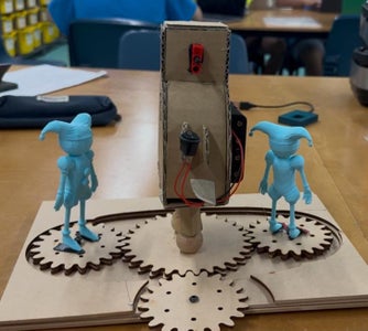

Step 2: Build Cardboard Instructables Robot
Now that we have the MDF gear board ready, we can measure out the proportions required for our Instructables robot which will be sitting on the 30 teeth gear!
  1. Make sure that the size of the Corrugated Cardboard available to you fits the size of the the Instructables bot you would like which will sit on top of the gears.
  2. Using the Instructables bot design given above, craft the different body pieces of the bot; this should include the 2 body shapes, 2 circular limbs, 2 wooden balls which represent the feet, 4 small cut pieces of the hand and 5 square slabs for the head and the top.
  3. The sizing for my Instructables robot started with a height of roughly 15cm and a width of about 7cm. This measurement fit the size of my 30 tooth gear which is placed under the bot
  4. ***All body pieces are doubled (eg. 4 hand pieces) in order to give the bot the required 3D look
Connect all the pieces together and make sure that the inside of the body is hollow to allow the *Bluetooth Speaker to fit within it
  1. Setup a Hot-glue gun and let it sit and heat before your start using it, also make sure that you put a heatproof mat below the setup to prevent any damage to the surfaces
  2. Bring the body pieces together and glue single pieces to each other and hold them together for 10 seconds until you let them sit and dry
  3. ***Make sure that the bottom of the body and the limbs are NOT connected yet as the Bluetooth speaker has to be fitted inside the body

Step 4: *3D Printing Character Files
You need to find a Character file of your choice, this can be found on many 3D printing file websites such as ETSY, Cults 3D, Printables, and Yeggi. Once you have found a file that you like, bring it into the CAD application (Fusion 360) and 3d Print this on the Adventurer 5M Pro. ***This is a optional step, wether you would like to 3D print your characters, construct them with cardboard, or just use a toy figure all options work.
These are the final steps to transfer the file to the 3D printer and actually 3D print it. Which brings your CAD creation to a physical product
  1. Plug in a USB drive compatible with Adventurer 5 Pro (must be Fat32) into your computer.
  2. Drag the g-code file from your desktop to the USB. Make sure the file is fully copied into the USB and remember to eject it before removing.
  3. Turn on the Adventurer 5 Pro 3D printer and pug in the USB.
  4. Go to the printing menu (2nd option from the top) and select the USB option.
  5. Find your file and select it. Click the green button to copy the file over to the 3D printer and start the printing process.
The printer will heat up and then start printing. This will take a few hours, the exact amount of time for your design to print will be displayed on the printer screen. Once it is finished, remove it carefully and clean up parts with any supports.
Place the character design onto the gears and make sure that the alignment doesnt collide with the Instructables bot
  1. Use a temporary sticky tape to place the character down onto the desired position and start spinning the gears slowly watching to see if there is any point of contact/disruption between the Instructables bot and the characters
  2. If there is, the best option would be to position the front of the body to the side of the Instructables body, that way when the smallest width is facing the front for the character, the largest width is facing the front for the Instructables bot. Vice-versa
  3. If there isnt, your good to go!
Now we take the gear board, the Instructables bot, and the 3d Printed characters into the design room to transform the aesthetic of the birthday celebration!

Glue the colored designs onto your board and 'sprinkle' some color onto the MDF boards to make it look like a cake!
You're Ready To Go!
Step 6: Instructable's 20th Birthday: Mechanical Cake
Play the Birthday song, Sing along, and Dance together
HAPPY BIRTHDAY INSTRUCTABLES πŸ₯³
