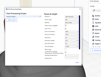

Before printing the parts, there are a few things to keep in mind. As a bonus feature, I added two embedded magnets inside the robot’s head. These magnets are super handy for holding screws and other small parts while you work.
To add the magnets, you’ll need to pause the printer at the right layer during printing. The easiest way to do this in Cura is:
  1. Go to Extensions > Post Processing > Modify G-Code
  2. Click Add a Script > Pause at Height
  3. Set the pause just before the layer that closes the magnet holes
Note: Different printers or slicing software may have their own methods for pausing. In my case, I’m using an Ender 3 with Cura.

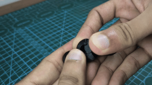

The second important thing to note is how you orient the ball joints on the print bed. If you print them vertically, they can easily break along the layer lines when you assemble them. To ensure they are strong and durable, it's very important to print them horizontally.
Robot Main Body printed with 0.15 layer height, 15% infill, No supports.
Ball joints printed with 0.15 layer height, 15% infill, With supports, and Wall line count of 5.

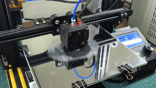

While printing the robot body, the printer automatically paused at the layer I had set earlier. At that point, I placed the magnets inside the head and then resumed the print.

I’ve also attached an image showing the difference between printing the ball joint vertically and horizontally—the one on the left was printed vertically and is much weaker, while the one on the right was printed horizontally and is far stronger.

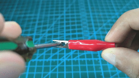

Step 8: Preparing the Alligator Clips
While the paint is curing, let's get the alligator clips ready. These will be the "hands" of our robot, used to securely hold PCBs or components.
  1. Remove the Insulator: The easiest way to remove the plastic insulator from the clip is to attach it to an object like a screwdriver and slide the insulator back.
  2. Solder the Wires: I soldered a 1.5mm² copper wire to the base of each clip. I also tinned the entire copper wire with solder to make it more rigid and less likely to bend.
  3. Add Heat Shrink: Next, I added heat shrink tubing over the soldered copper wire and slid it down into the 3D-printed part(Mine is tight fit, You can add tiny amount of superglue)
  4. Heat Shrink on Teeth: I also added heat shrink tubes over the teeth of the alligator clips. This will prevent the sharp teeth from damaging or scratching the delicate components you're holding.
