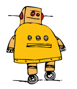

First of all, we have to create the outline of the robot using an image editing software. To do this I used a colour image of the robot. Note that I have removed the antennas. Keep reading and you will know what is going to happen to them! We want to save it as a .BPM file. Once we have this, we have to import this outline to the PCB software.

For this PCB, I wanted a simple circuit and something that could go well with the design so I thought about putting two red LEDs to be his eyes. To power a LED we will need resistors and a battery holder as well.
