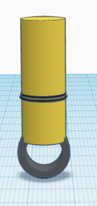

Step 1: Models
These are the basic tinkercad models I used. I will not go into great detail on how I built these in this instructable, but for a step by step guide to the instructables robot I encourage you to go read this Instructable. :) https://www.instructables.com/Instructables-Robot... He was my entry for this same contest last year :) {no I didn't win anything lol}
