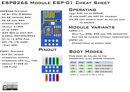

The electronics of the project are not very complicated, but the ESP8266 module requires some special treatment to get it to work. So first of all, what is this ESP thing all about?
The ESP8266 is best known as a low-cost WiFi chip, but it also has a full fledged microcontroller unit capability. This makes it ideal for projects that require WiFi and controlling of external components like our 7 segment display. The programming is done with a USB to serial converter, also called an FTDI converter.

When powering up the ESP8266, it will enter one of its "boot modes", depending on the voltage at its IO pins. In other words: if we want it to execute our code when it boots, we'll have to configure this!
For program execution this means:
- CH_PD to VCC
- RST to VCC
- GPIO0 to VCC
- GPIO2 to VCC
While for programming the device, this translates to :
- CH_PD to VCC
- RST to VCC
- GPIO0 to GND
- GPIO2 to VCC
As can be seen, the only difference is the state of the GPIO0 pin. Hence, we'll us a push button to connect GPIO0 to GND when programming.

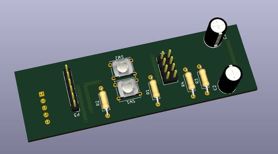

PCB
To make the PCB, I designed a perfboard/stripboard layout in KiCad (an open source PCB layout software). By setting the grid spacing to 2.54mm (0.1 inch), you can make layouts which can be soldered onto stripboard.
This makes it super easy to solder the electronics together: simply print out the design (included as a PDF) and copy the design on the stripboard. Use header pins to connect the screen, FTDI and ESP8266.
After soldering, cut the perfboard to the right size and plug in all the components.

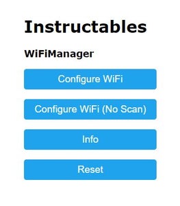

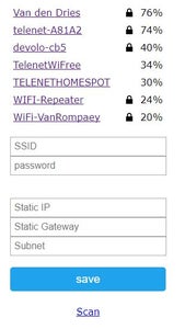

- On your PC, go to your WiFi networks and select "Instructables Hit Counter"
(When asked for a password, enter 'password'.) - A browser window should open (otherwise open one yourself and type in 192.168.4.1)
- A page opens, press "Configure WiFi"
- Choose a network and type in your password. Fill in a static IP, gateway and subnet
- Hit save, a confirmation page will appear

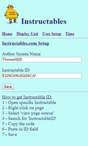

User Setup

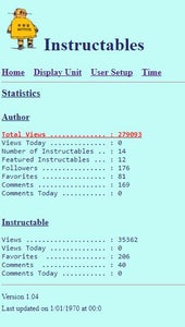

- Open a browser and type in the static IP you choose in the previous step.
- Go to the "User setup" tab

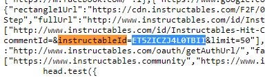

- Fill in your Instructables name and save
- To see the views of a specific Instructable, follow the instructions on the page
- Hit save, your views will now be displayed!

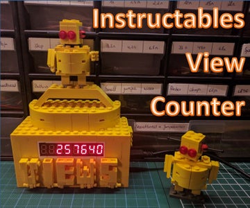

Step 5: Casing
This is the part where you can get super creative. Any case can work, but making a nice one can make or break a project. Therefore, I decided to make mine out of Lego!
Mounting the screen
To fix the screen in place, I found that a "Lego panel without side support" fits the screen perfectly. There is only one downside: it's twice as wide as I'd like... Fortunately, this is easily solved by cutting it in 2. We now have a nice mount for the display, and a good starting point for the whole case!
Making the letters
To make it more obvious that this is a view counter, I wanted to include a label with "views". But then I thought, why use a stupid label when you can make letters out of Lego? So that's what I did!
I included a close up off the letters such that they are easier to replicate.
Making the robot
I was looking for something to finish off this build, and stumbled across this awesome instructable: https://www.instructables.com/id/Lego-Instructable...
The instructables robot built out of Lego, the perfect companion for the view counter! I won't go into the detailed steps of making it here, since it is explained step by step in the original instructable.
Our little companion is the finishing touch to our case; we're done!
