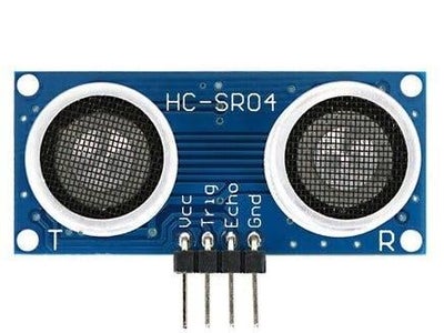

HC-SR04 Sensor.

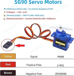

3 x SG90 Servos.

Dimensions were taken from standard sg90 servos to create cut-outs in the body for 3 x servos, one for each arm and 1 for the head, only the top part of the servos will protrude through the body.

We can sketch the Head of the Robot next, this has to be big enough to house the HC-sr04 Sensor, this component will also be the eyes of the Robot, the idea is that the robot will move in a forward direction and when an obstacle appears, the head will revolve right to left to look for a clear exit.

The 3 servos were then secured, initially with CA Glue to set in place, then hot glue, at this point the servos were all centralized with a servo tester.
The arms were secured to the servos with the little screw that comes with the servo, the design was such that the hole on the arm inner was just offset slightly to the servo spline, so a snug push fit, then secured with the screw, there is no stress on the arm servos so this will work fine.
The head base was installed the same as the arm servos but I used one of the horn screws, these are bigger, and would secure the base and head better.
The sensor was cabled up, then set in place with hot glue, the head, I made an error with the cable outlet on both the head body and base, so I cut a small section in the head body away with cutters at the back, this was filled with a round file and worked very well.
