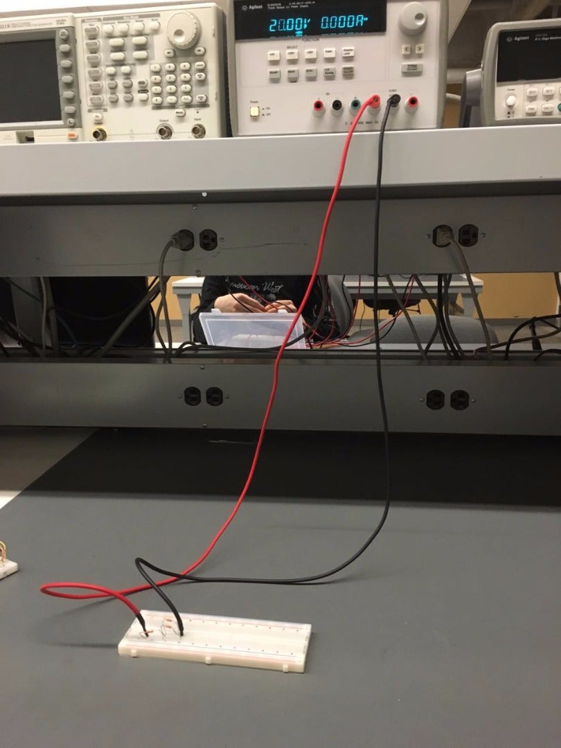

Step 4: Supply Power for the Circuit.
1. Get two wires from a laboratory.
2. Plug in one side of these two wires into a power supply. For this case, we need to use the 25V output port.
3. Connect another side of the wire which is from anode into the same line with the front end of the 22k resistor.
4. Connect another side of the wire which is from cathode into the same line with the back end of the 10k resistor.
5. Push "power" button to turn on the power supply.
6. Push "output on/off" to turn on the output.
7. Push "+25V" button to display the voltage of output which we are using on the screen.
8. Adjust the value on the screen to 20V.
Warning: Make sure the power supply is off when we are not using it or we have not check our circuit. There is an “output on/off” button on the power supply. This is used to control the output.

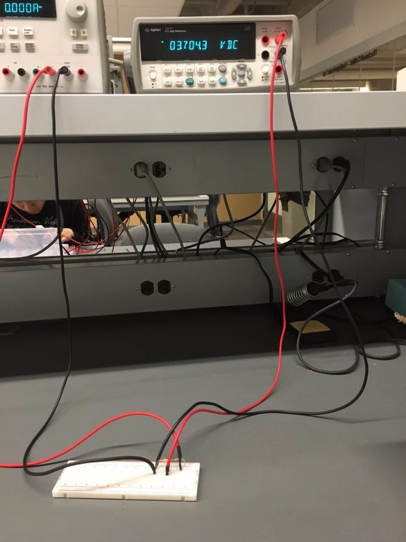

Step 5: Verify Our Circuit.
1. Plug in one side of two wires into a multimeter. The wire should be plugged in to the port which is used to measure voltage, just like the figure.
2. Parallel connect another side of the two wires with each resistor consecutively.
3. Turn on the multimeter and press the DCV button. We are using DC voltage mode as our power supply, so we need to use DCV mode to measure the voltage across each component.
4. Read the measurement to verify our circuit. The voltages we got from this circuit are exactly same with our calculation. Therefore, we built the circuit correctly.
Reminder: Pay attention to the port we use on multimeter. The red port below the black port is used to measure current. Don’t use that port to measure voltage.
