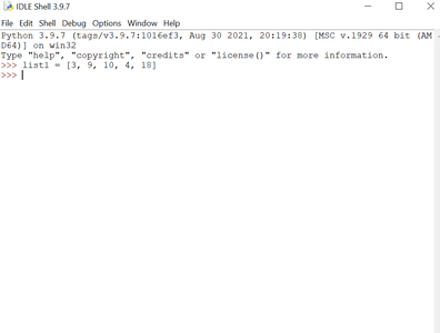

An IDLE (Integrated Development Learning Environment) is an application that will help you code in Python. If you don't have it downloaded, go to Python.org/downloads/ and choose the right download for your computer (Windows, Mac, Linux, etc.). On an updated Windows Device, your IDLE application will look like this. Click on it to open the IDLE Shell, where you'll be making your 'for' loop.

'For' loops iterate through something. In this example, we'll be making a 'for' loop that iterates through a list. As shown above, I named my list 'list1'. We'll iterate through each number in the list using the 'for' loop. Lists use square brackets. When you're making a variable name for your list, make sure to not literally use the word 'list', because it has a built-in meaning for the IDLE, and can cause problems when you're running your code. Note that although I put numbers in my list, you're also free to use other acceptable Python text types.
