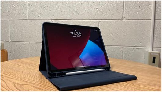

-      (Roku, Xbox, Switch, or Computer): The device used in this guide will be an iPad with an HDMI adaptor.

Step 3: Locate the HDMI Port on the Device You Want to Record. for This Example, the Device Being Recorded Is an IPad With an HDMI Adapter
Step 4: Insert the Other Side of the HDMI Cable Into the HDMI Port on the Device Intended for Recording

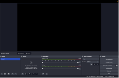

Step 8: Open OBS

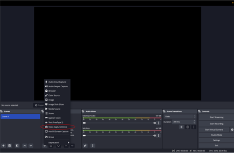

Step 9: Click the “+” Under Sources, Click “Video Capture Device”, Then Click OK

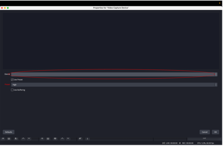

Step 10: Click the Rectangular Bar Next to “Device”
Step 11: Click on Game Capture HD60S+, Then Click OK

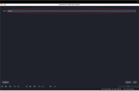

Step 13: Click “Audio Input Capture”
Step 14: Click the Device Option
Step 15: Click on Game Capture HD60S+, Then Click OK
