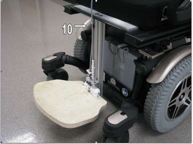

Step 2: Mounting the Spring
Cut a piece of wood for footboard that is approximately 10' X 10" X 1" with 5lbs < weight < 10lbs.
Mount torsion spring to footboard (#1 in figure) using 1' screws.
Step 3: Mounting Board to Chair
Drill three holes through one long face of smaller aluminum block (2). Center hole is for setscrew (3). Other holes are for 80/20 fasteners (4) mounting to long 80/20 segment (5). Bit size matches selected screw diameter.
Thread setscrew hole.
Drill one hole through the long face on top of small aluminum block, adjacent to face with three holes. Bit size to allow passage of torsion spring extender through small block.
Drill one hole on the same face, away from the center hole. Bit size matches that of spring plunger.
Thread spring plunger hole.
Assemble footboard with mounted spring to the small aluminum block with spring plunger (6) and secure to 80/20. It is recommended to attach a board to the opposite end of 80/20 to be laid on work surface for stability.
Step 4: Attaching Cable System
Drill one hole through a side of the bracket (7) to pass a fastener. Drill one hole through the other side of the bracket to pass the cable.
Pass the cable through the bracket. Using a sturdy connector (8), secure end of cable to top of spring plunger. Key ring was used.
Using an 80/20 fastener (9) secure the bracket to the side face of the longer 80/20 segment. Position such that cable is allowed to move during pull until connector meets bracket. Force of cable pull will lift plunger spring to remove locking mechanism and permit footrest to move.
Secure hook-eye screw (10) to outer face of long 80/20 and thread cable through such that it is guided up and around user legs.
Handle (11) can be laid next to the user when not in use.
