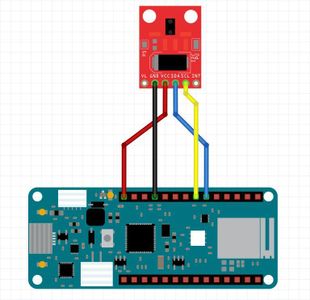

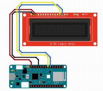

Step 3: ​Circuit Diagram
The main elements of my design are
  • Gesture sensor
  • Arduino Wi-Fi 1010
  • LCD
  • Smartphone
The electronic modules I used for prototyping are grove based. Connecting them is a child's play. The sensor and LCD both use I2C protocol and the Arduino I am using has only one I2C port so I have used an I2C hub to connect all three modules. Please refer to the below schematics for connecting the modules.

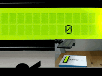

Step 4: ​Lets Assemble It
I have used a product box of a charger to assemble my project. Ideally, I would love to design and print a custom enclosure but I don't have access to a 3D printer. I have slightly modified the box and it does a fantastic job of housing the circuit. It also hides the cluttered wiring and makes it look clean.
Code for this project is available here.

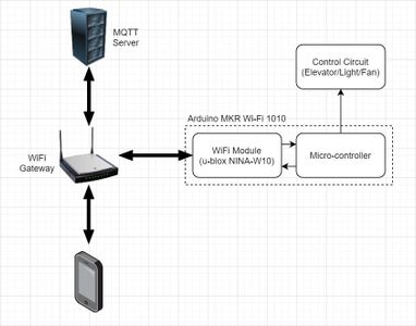

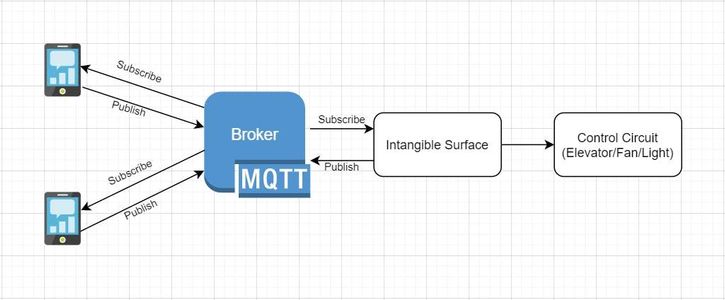

5.2 IoT (Someone Else's Computer)
In this method, your smartphone acts as a remote control. The app on your phone uses the MQTT protocol over WiFi to communicate with the intangible surface. When you click a button on your mobile app, it publishes a message to a topic. The Intangible Surface reads that message by subscribing to that topic. After processing the message it sends a control signal to the device it is controlling. Intangible Surface then publishes the feedback message to the topic which is then reflected by the mobile app.
To know more about MQTT protocol please click here. I used the Mosquitto broker installed on a RaspberryPi (acting as a server) to test this design. I have also tested it with CloudMQTT. You can use any MQTT broker of your choice.
A clear benefit of this method is that multiple people can control the same device at the same time. So you and your friend can select different floor numbers in an elevator at the same time using your smartphones.
The smartphone app I am using to talk to the Intangible Surface is called MQTT Dashboard. I have designed various control interfaces in it according to the different applications.

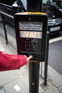

You might have seen and used a switch at a pedestrian crossing which looks like the one in the above image.
It's a very simple interface. You press the button and wait for a while until the signal turns green. Once the signal is green, it tells you to walk. This functionality can be replicated using intangible surface. In the new interface just swipe LEFT or RIGHT to activate the signal. Voila!

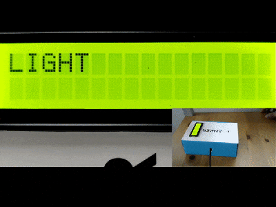

Step 7: Applications - Light Switch
You must have used an on/off switch to control a light or any other electrical appliance. It can also be replaced with our touch-less interface. Simply swipe RIGHT to turn ON the light and swipe LEFT to turn it OFF.
Step 8: Applications - Fan Control
You might have seen a fan switch and a knob to control its speed(Sorry! I can't find a royalty-free image). Lets replicate that interface using Intangible Surface.
Swipe RIGHT to turn ON and swipe LEFT to turn OFF. Rotate your hand CLOCKWISE to increase the speed and ANTICLOCKWISE to decrease the speed.

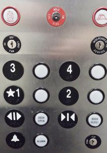

Step 10: Applications - Elevator Floor Selection Interface
The floor selection interface inside the elevator is generally quite complex. You will find lots of buttons like the one shown in the image above.
These buttons are divided into 3 main category
  1. Floor selection buttons.
  2. Door control buttons.
  3. Alarm/Emergency button.
We can replace these 3 functionalities using our Intangible Surface.
  1. Using the touch-less interface we can select the floor by rotating our hand CLOCKWISE or ANTICLOCKWISE. If a building has too many floors then you can swipe LEFT or RIGHT to decrease or increase the floor number by a factor of 5, respectively.
  2. For door control, simply swipe UP to open the door and swipe DOWN to close.
  3. To activate the alarm, wave your hand.

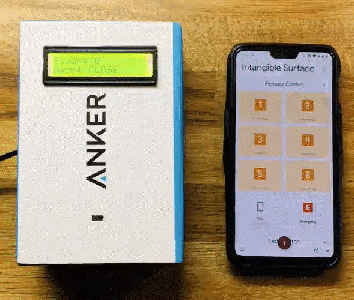

Step 11: Applications - Mobile As a Remote (IoT)
I have implemented the Elevator control using IoT also. Using this method, one can interact with the elevator using a smartphone.
