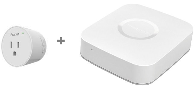

The Peanut Plug is a Zigbee based smart plug with power
monitoring capabilities. It can be plugged into a standard wall outlet and used to turn on and off your devices when hooked up to a smart-hub like Samsung’s SmartThings. Unfortunately, the SmartThings Hub doesn’t natively support the Peanut Plug out of the box. Luckily, a little bit of modification to the software will seamlessly bring the plug online and the procedure to get you there will hopefully be but a distant memory.

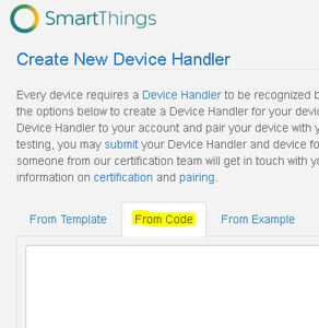

Choose “From Code” tab and paste the raw text code found here in the space below. (Thanks to parkmanwg for writing the code!)
For more info on the code used go here.
Choose Create to complete this step

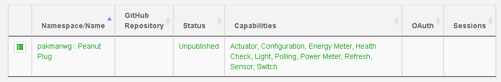

Now under Device Handlers, you should have a new device, the Peanut Plug.

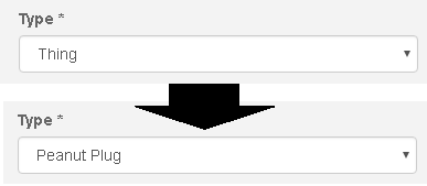

Scroll down to where it says Type*
Under Type* you will see your device listed as a Thing.
Click on the dropdown and choose Peanut Plug. For me, the Peanut Plug is the last option (it was not alphabetical). Choose Update to complete the action.
Now, in your application, you will see the Peanut Plug as adevice with on/off and power monitoring capabilities.
