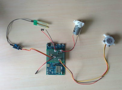

Step 2: How the System Works
The heart of the project is Intel Edison board.It is hooked up to the various sensors (like soil moisture,light,temperature,water flow etc) and a Water Pump.The sensors monitor the different parameters like Soil Moisture, Sun Light and Water flow/ Consumption then fed to Intel Board. Then the Intel board process the data coming from the sensors and give command to the Water Pump for watering the plant.
The various parameters are then send to web through the the Intel Edison inbuilt WiFi.Then it is interfaced with Blynk apps for monitoring the plant from your Smartphone/Tablets.

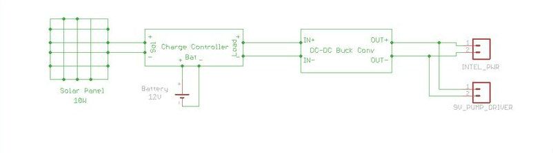

Step 4: Power Supply
We need power for this project for two purpose
1. To power the Intel Edison (7-12V DC) and different sensors( 5V DC)
2. To run the DC pump (9V DC)
I choose a 12V sealed lead acid battery for power the entire project.Because I got it from a old computer UPS.Then I thought to use Solar Power to charge the battery.So now my project is completely reliable and eco friendly.
See the above images for preparing the Power Supply.
The Solar Charging System is consists of two main components
1. Solar Panel : It convert sun light to electrical energy
2.Solar Charge Controller : To charge the battery in a optimum way and control the load
I have written 3 instructables on making a Solar Charge Controller.So you can follow it to make your own.
ARDUINO-SOLAR-CHARGE-CONTROLLER
If you don't want to make, then just buy it from eBay or Amazon.
Connection :
Most of the charge controller have commonly 3 terminals : Solar,Battery and load.
Connect the Charge Controller to the Battery first, because this allows the Charge Controller to get calibrated to appropriate system voltage. Connect the negative terminal first and then positive. Connect the solar panel(negative first and then positive) At last connect to the DC load terminal.In our case the load is Intel Edison and DC pump.
But Intel Board and pump needs a stable voltage.So a DC-DC buck converter is connected at DC load terminal of the Charge controller.

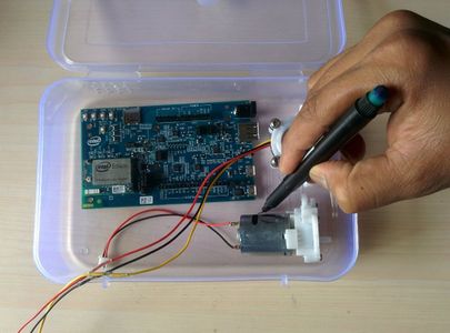

Step 9: DC Pump
The pump is basically a geared down DC motor, so it has a lot of torque. Inside the pump is a ‘clover’ pattern of rollers. As the motor turns, the clover presses on the tube to press the fluid though. The pump does not need to be primed and in fact can self-prime itself with water a half meter with ease.
The pump is not a submersible type.So it never touches the fluid and makes this an excellent choice for small gardening.
Driver Circuit :
We can't power the pump directly from the Edision pins as the Edison pins can only supply a small amount of current. So to drive the pump we need a separate driver circuit.The driver can be make by using a n Channel MOSFET.
You can see the driver circuit shown in above picture.
The pump have two terminals.The terminal marked with a red dot is positive.See the image.
The Dc pump is recommend to run at 3V to 9V . But our power source is 12V battery.To achieve the desired voltage we need to step down the voltage.This is done by a DC Buck Converter.The out put is set to 9V by adjusting the on board potentiometer.
Note : If you are using IRL540 MOSFET then no need to make the driver circuit as it is logic level.
Preparing the Pump Connector:
Take two pin JST connector with wire.Then solder the red wire to the polarity with dot mark and black wire to the other terminal.
Note: Please do not test long time with no-load, inside is with plastic leaves, can't suction impurity.

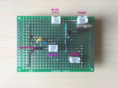

Step 10: Prepare the Sield
As I did not have groove shield for sensors connection.To make the connection easier, I made my own.
I used a double sided prototype board ( 5 cm x 7 cm) for making it.
Cut 3 strips of straight male header pin as shown in picture.
Insert the header to the Intel female headers.
Place the prototype board just above it and mark the position by a marker.
Then solder all the headers.
Step 11: Make the Cicrcuit
The shield is consists of :
1. Power Supply Connector ( 2 pin )
2. Pump Connector (2 pin ) and its driver circuit ( IRF540 MOSFET ,2N3904 Transistor,10K and 1K Resistors and 1N4001 anti parallel diode)
3. Sensor Connectors :
- Moisture sensor - The connector for moisture sensor is made with 3 pin straight male headers.
- Light Sensor - The light sensor connector is a 2 pin JST female connector, the associated circuit (10K resistor and 0.1uF Capacitor) is made on the shield
- Flow Sensor : The flow sensor connector is a 3 pin JST female connector.
4. Pump LED : A green LED is used for knowing the pump status. ( Green LED and 330R resistor )
Solder all the connectors and other components as per the schematic shown above.

To make the system compact and portable, I put all the parts inside a plastic enclosure.
First a place all the components and marked for making holes ( for pipe,Cable Tie to fix the pump and Wires)
Bind the pump by help of a cable tie.
Cut a small silicon tube and connect between pump discharge and flow sensor.
Insert a long silicon tube at the holes near to the Pump Suction.
Insert another silicon tube and connect it to the flow sensor.
Install the buck converter at the one side wall of the enclosure.You may apply glue or 3M pad just like me.
Apply hot glue at the base of flow sensor.
Place the Intel board with the prepared shield.I applied 3M mounting squares for sticking to the enclosure.
Finally connect all the sensors to the corresponding headers on the shield.
