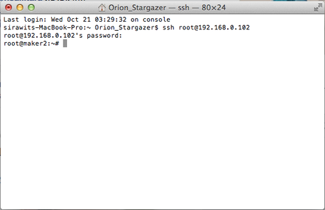

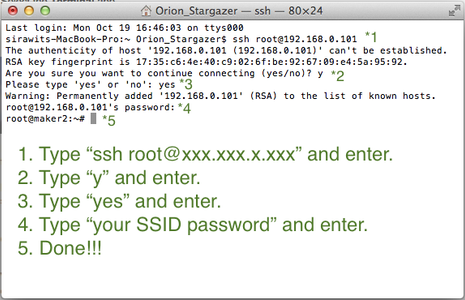

Step 3: SSH to Intel Edison
This step will help you upload and control your Intel Edison without a USB cable. And again you can do it by following the instructions on the Sparkfun website.
Sometimes I found an error when I tried to connect SSH. The solution is in the picture.

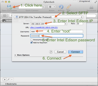

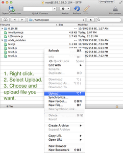

I use SSH through terminal for running the program and config for Edison. And I used Cyberduck to upload the program to Edison.

  1. Connect to your Intel Edison by typing "ssh root@xxx.xxx.x.xxx" in Terminal (Replace x with your Intel Edison IP) Enter and follow the steps on screen. More detail in SSH step.

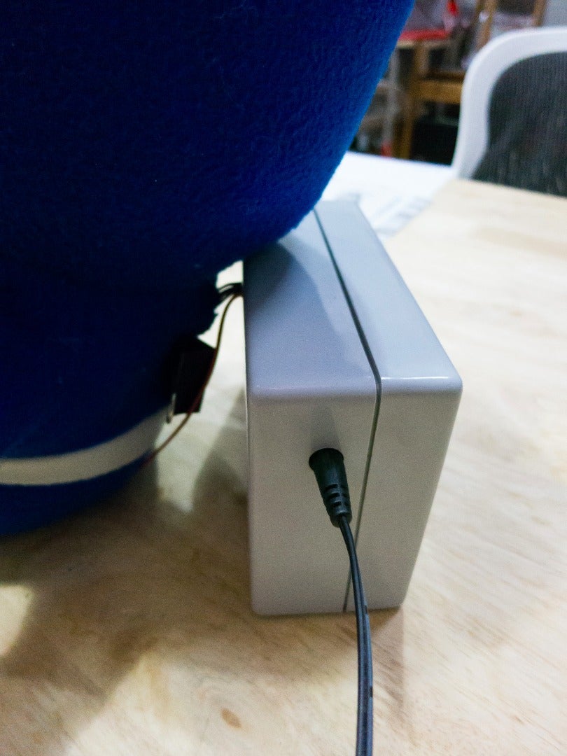

Step 7: Make Edison Case
I used enclosure 10.3*14.9*5.7 cm^3. You can use the same as me or another you want.
  1. Drill 1/8" hole for holding the Intel Edison in the box.
  2. Drill 1/4" hole for wiring.
  3. Drill 3/8" hole for power supply jack.
  4. Put Intel Edison into the box and attach it.
More detail in pictures.

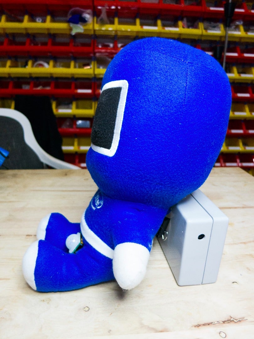

Step 8: Matching Body & Brain Together
It's time for connect your Intel Edison to your Intel Bunny. Let's Go!!!
  1. Wire every wire from the doll and PIR motion sensor through the hole on the case.
  2. Connect The Y - connector to 5V pin.
  3. Connect the pin from the PIR motion sensor to the Arduino Breakout Board.
  4. Connect the pin from the dot matrix module (pin from the doll) to the Arduino Breakout Board.
  5. Close the case and fasten screws securely.
  6. Place the PIR motion sensor where you want it.
More details in pictures.

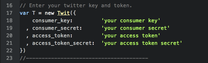

  1. Open "intelBunny.js" using Text Editor. I suggest ATOM. It is a nice text editor for programming and it's Free!!!

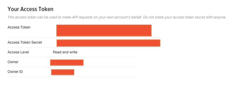

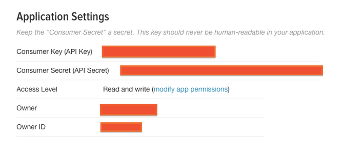

  2. Enter your Twitter consumer key and token. If you didn't have one, click and select "Create New App".

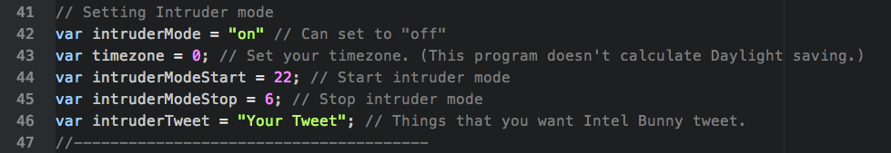

  3. Set your timezone and time that you want to put your smart doll into "intruder mode" (Burglar alarm).
  4. Edit your text that you want your Intel Bunny to tweet to you.

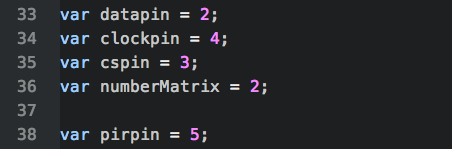

  5. You can set your own connection pin as you want. (Optional)

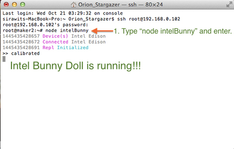

Step 10: Upload Program to Intel Edison and Let's Rock!!!
  1. Connect your doll to a power supply.
  2. Connect your Intel Edison by SSH with Cyberduck and Terminal.
  3. Upload "intelBunny.js" with Cyberduck.
  4. In terminal type "node intelBunny" for running the program.
  5. You may adjust the PIR motion sensor parameters. (Optional)
  6. Done!!!!!

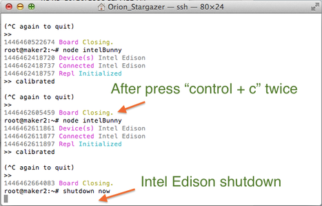

Addition
  • Sometimes when you power up your Intel Edison again. Edison will connect to your network with a different IP but you can guess what it is because it usually changes only a little -- for example: your old IP might be xxx.xxx.x.102 and you new one may be 100 - 104.
  • If you want to stop the program press "control + c" twice.
  • If you want to shutdown you Intel Edison type "shutdown now" and press enter.
