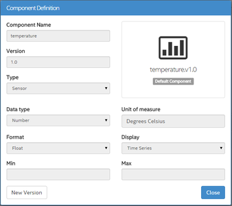

First of all you can find all the possible components in your Catalog which you can find on your IoT Analytics Dashboard. There are standard three sensors already registered:
- humidity humidity.v1.0
- powerswitch powerswitch.v1.0
- temperature temperature.v1.0

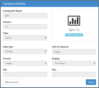

We're going to make two additional sensors: the sound and light sensor.
- Click on Add a New Catalog Item
- Give your sensor a name and type this in the Component Name box.
- Select a Type: Sensor or Actuator, in our case Sensor.
- Select a Data type, we can pick Number.
- Select a Format, pick Integer or Double if you want decimals (for example the temperature sensor).
- Select a Display, there's only one option so pick Timer Series.
- Type a Unit of measure, for examples Celcius.
- Optional: set min and max values.
You can review the sensors on the Catalog tabs. Or you can use the terminal and type iotkit-admin catalog this should bring up a table of all the sensors. Bellow you can find the IoTkitRegisterExample sketch. It's very well commented so read carefully and apply the changes. You'll have to replace YOUR_DEVICE_ID with your Device ID. Also, you'll have to replace the XXXXXXXX with your generated Activation code. Edit the register sensor part to meet your used sensors. Upload this modified sketch to your Arduino.
