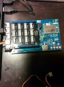

Introduction: Intel Edison Arduino Laser Break Beam Sensor
About: lost my arm at 18, now I'm hacking stuff for disabled people (or animals)
A cheap laser break beam sensor.
Step 1: Parts
Parts: Laser module (recycled but new ones available @ https://www.adafruit.com/products/1056)
Light sensor (I used the one that came in the iot dev kit, but the cheap ones work fine @ https://www.adafruit.com/products/161)
Intel Edison Arduino @ https://www.adafruit.com/products/2180
Step 2: Program Intel Edison
http://www.intel.com/content/www/us/en/do-it-yours...
Download the Intel Arduino IDE from the link above.
https://github.com/intel-iot-devkit/upm/blob/maste...
Download the light sensor code
Upload the code to the edison
Step 3:
When installing the light sensor, it may require a shroud of some type, too much ambient light can throw off the sensor.
