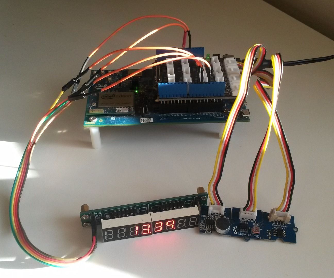

- Intel® Edison board and power supply
- External Wi-Fi* antenna (optional)
- From the Grove* Starter Kit
- Seeed Studio* base shield
- Temperature sensor
- Relay
- Push button
- LED
- LCD
- Heat lamp and power supply
- 5V ventilator fan
The majority of the sensors are from the Grove* Starter Kit for Intel® Edison board which is designed to make bread boarding and wiring circuits easy. The base shield slots in on top of the Intel® Edison board and with the Grove cables, you simply plug in one end to the sensor and the other end to the slot on the shield. Always make sure the board is not powered on when changing wires and cables around. Also toggle the Grove shield to be set on 5V, otherwise the sensors in this tutorial will not have enough power.

Step 1: Sensors - Temperature Sensor
The temperature sensor is the main component of this demo and should be plugged into slot A0 for analog signals. The temperature will be recorded in degrees Celsius in this case. Make sure to place the sensor near the heat lamp to get a good reading.
Step 2: Sensors - Push Button
Plug the push button into D8 for digital input. When you press the button for a second, it will turn the ventilator fan on or off the manually.
Step 3: Sensors - LED
The LED light is an indicator for the ventilator, that is, the LED is ON when the ventilator is ON. It needs to be plugged into D2.
Step 4: Sensors - 5V Ventilator
This device is not part of the Grove Starter Kit, so the wiring is a bit more complex. To power the ventilator, the 5V input wire needs to go into digital pin ~3 as labeled on the side of the board and the Power GND wire needs to go into one of the GND pins on the other side of the board. Make sure not to swap these because it will cause the ventilator circuitry to burn and become unusable. Point the ventilator at the heat lamp so that it cools it down when turned on.
Step 5: Sensors - Relay and Heat Lamp
The relay is plugged into D4 and is responsible for controlling the heat lamp. The heat lamp requires its own external power source in this case as it needs more than 5V, which is the maximum voltage the Intel® Edison board can supply, hence the relay will act as the electronic switch between the board and the lamp to turn it on and off. To connect the heat lamp to the relay, connect the relay’s NO contact (on the left) to the positive contact on the lamp and the CO contact (on the right) to the positive contact that goes into the power source. For the ground, connect the lamp to the power source ground directly.
Step 6: Sensors - LCD
The LCD can go in any of the four I2C slots. The LCD displays the temperature value and the background color changes from green to orange and red depending on thresholds that are passed (below 30 is green, between 30°C and 40°C is orange, and above 40°C is red).
