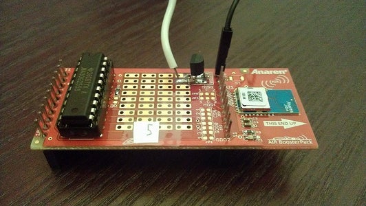

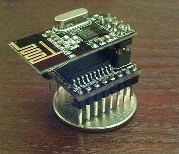

Step 4: Add Hardware Nodes
We currently have tested two kinds of nodes - a 915MHz MSP430 and 2.4GHz LPC812. The LPC812 design files can be found in this repository. Constructing the MSP430 node will be covered in a future Instructable.
