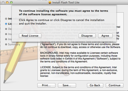

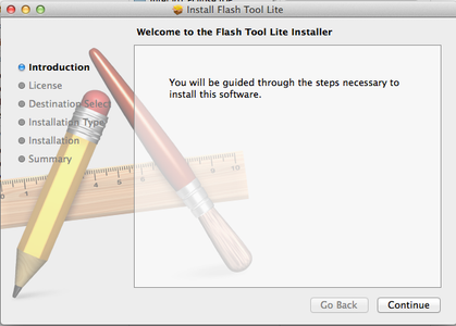

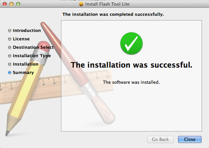

- Open FlashToolLite_5.2.1.111_mac64.pkg, and follow the install guide.
- Done! But don't open the software, we need to prepare the Intel Edison first!

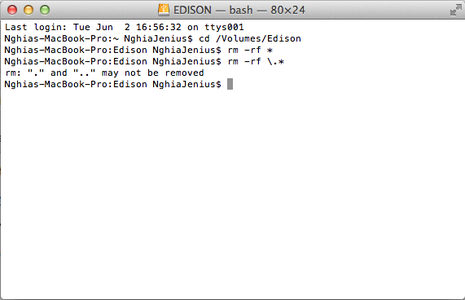

*** Remove old image files in the Edison:
- Open Terminal and type these commands (hit Enter before moving to the next line)
cd /Volumes/Edison rm –rf * rm –rf \.*

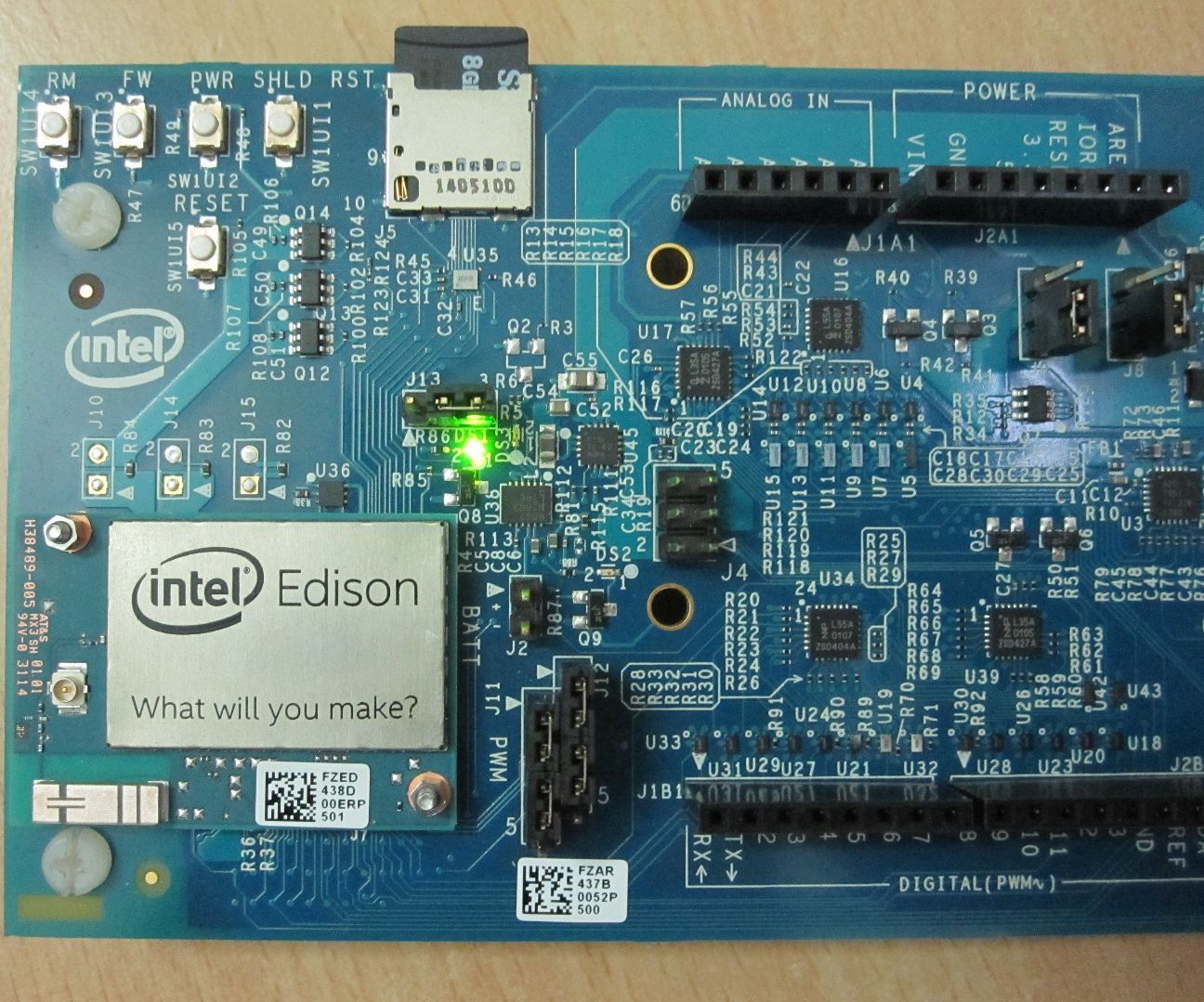

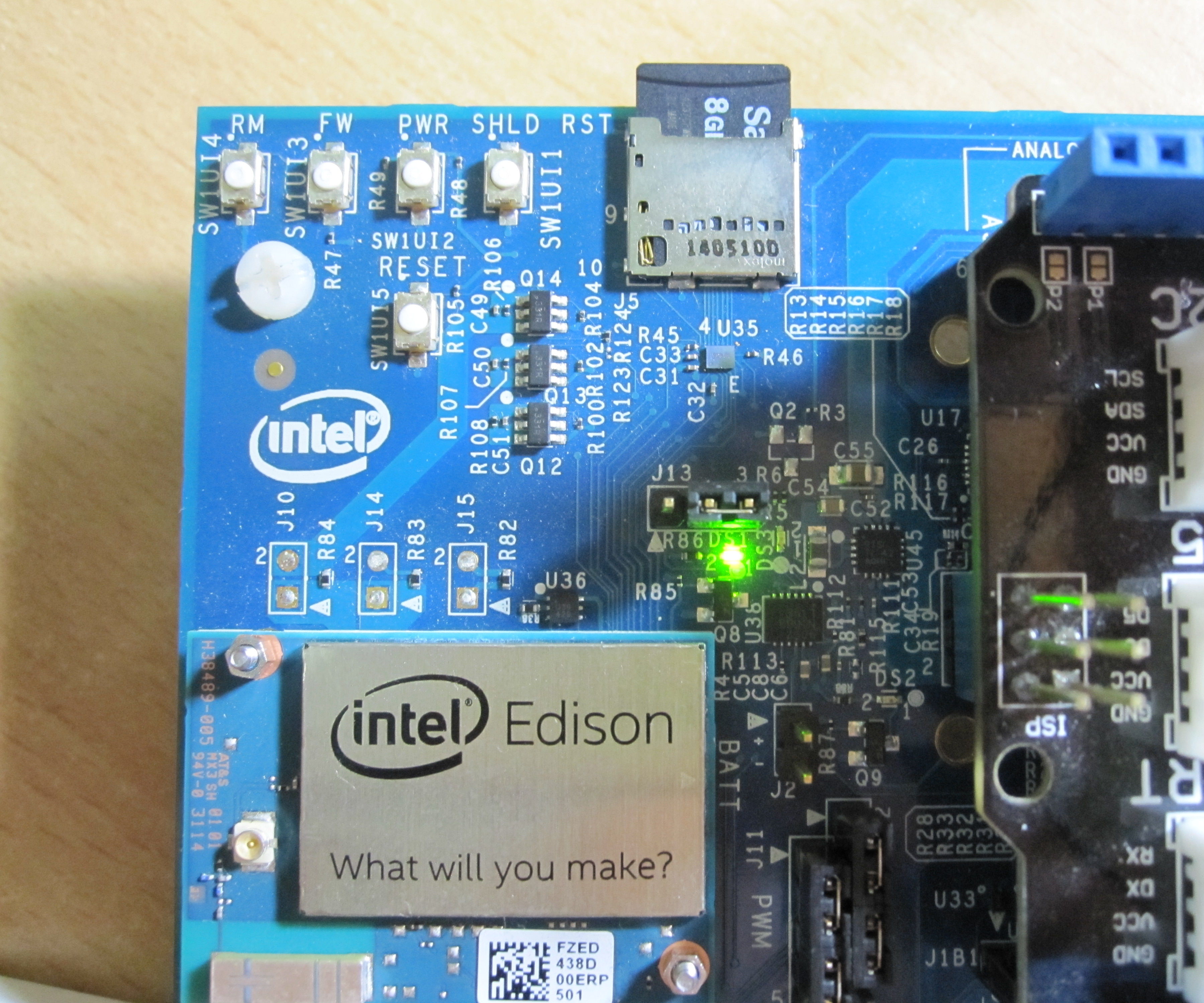

- Setup the Edison board: make sure the micro-switch is on micro-USB ports side, and unplug your Edison from computer.

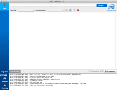

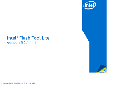

- Open the Flash Tool Lite.

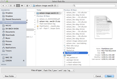

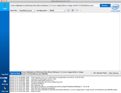

- Choose Browse, and select FlashEdison.json file in the unzip image folder, and Open it.

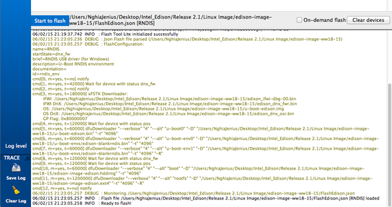

- You will notice the Log Info (On the bottom) update and say "Ready to flash!", you can also change Log Level to DEBUG or TRACE to view more processes.

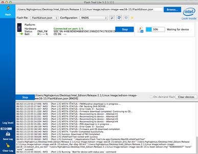

***Important: The flash process only works when the Edison is booting, so:
- First, unplug the Edison
- Hit Start to flash on the software
- Then plug the board again to your Mac, the flashing process will start automatically.
Also, you can observe the flashing process in real-time by access the Edison via Serial Terminal:
screen /dev/cu.usbserial-A502LRRQ 115200
You may get errors on your first try, and it's obvious. Here is my advice:
- Try to use another USB port. I got the errors because of this problem, I think the software only recognize one USB port only (I have two ports, and only one works, the other is used as serial terminal which I have mentioned above)
I have printed screen all the processes, so take a look before starting!
