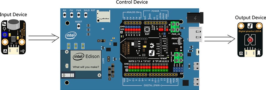

Had you ever been curious about the voice activated bulb in your childhood? Had you ever stamped again and again and just turn on the light? As long as you clap your hands, the light will be turn on. In this section we will make such a voice activated bulb. We would use a sound sensor. Through this sensor, we can make much more interactive stuffs, such as voice activated flaring drum.

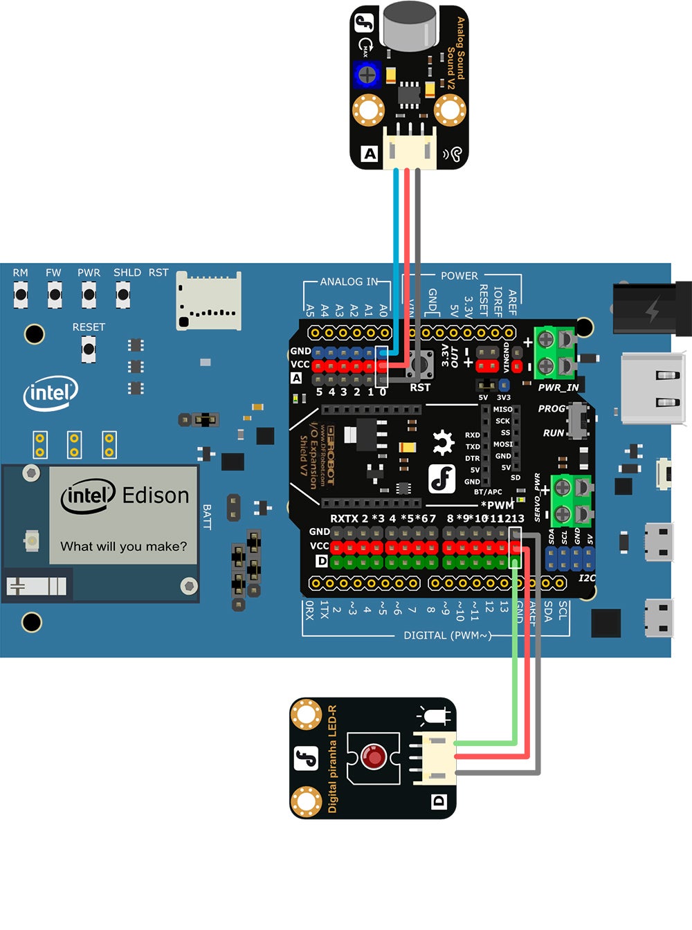

Step 1: Connection
Analog Sound Sensor → Analog Pin 0
Digital piranha LED light module → Digital Pin 13
