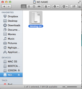

First, download and run the Arduino Example code for data logging ( I have attached it in here).
Next, you should open the Serial Monitor and see the data flow. Then, remove the micro SD card, put it to PC via adapter and check it out. If all run well, you will see a text file named "datalog.txt". Open it, you will see the data flow was logged in lines. Tada, now you know how the data is logged.
Finally, for a full system development, I have modified the example and put real pressure sensor data in SD card. You can use it as your own purpose and spend less time figure it out!
