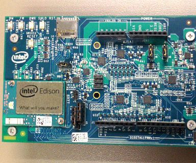

- Intel Edison with Arduino breakout board

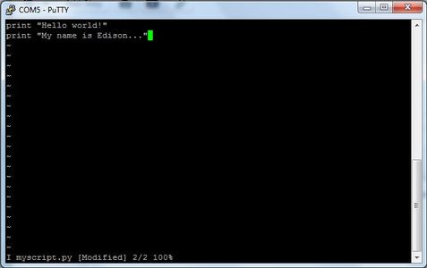

To create a new script we will use a basic editor called "vi". Follow the next steps:
- In terminal type vi myscript.py and hit enter.
- vi opens, to start writing type i to activate insert mode
- Write your Python code (See images)
- To stop editing press "Esc" key
- Write :wq to write file and quit
