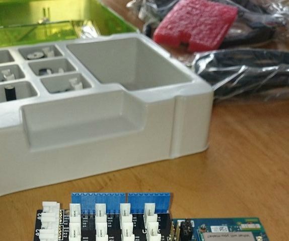

Step 1: Getting the Parts
Time to go part collecting!
For this bit you're going to need the following,
(remember I am using modules from the grove kit from seeedstudio)
1* Intel Edison
1* Edison Arduino Expansion Board
1* LED driver board
1 * LED of your choice (I used a green)
1* relay board / relay
1* temperature sensor
4* Module connect cables
If you need to buy them you can get the kits here
Got all of them? Time for the next step -->
