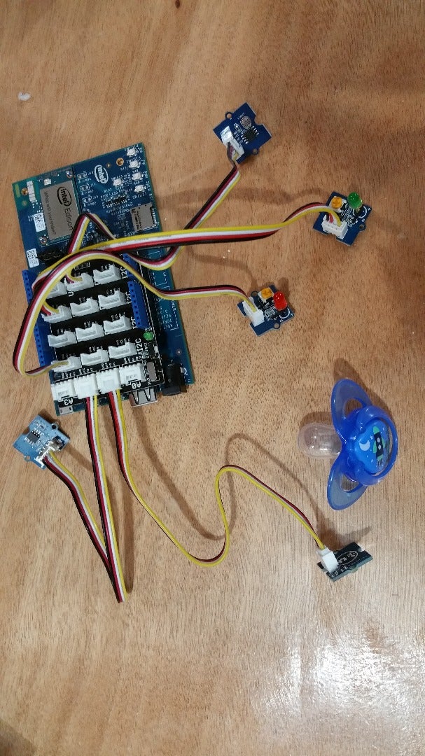

Step 2: Get Wired Up
This step is not too different from Part 1, whereby all the required sensors are attached to the Edison Arduino Shield and registered within the software to start taking samples.

Step 4: Get It Together
Once you have all the pieces together the process of compacting it all into he small pacifier shape begins. In order to help you get this job done you'll probably need the following tools:
- Scalpel - resize those big boards to fit inside the Nib and or through the holes of the Pacifier.
- Cable cutters - shorten those wires to get everything connected.
- Glue Gun - Use this wise tool to get everything put together.
- Metal Nail File - get rid of the sharp dangerous edges. (warning to not test on actual baby!)
