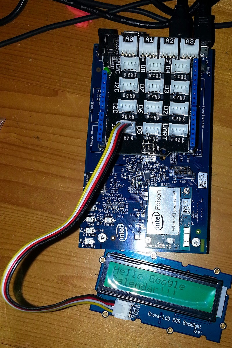

In this instructable we'll configure step by step an Intel® Edison Arduino Board, so that it notifies you about upcoming events from your Google Calendar, by displaying the event summary and location on the Grove RGB LCD screen and even buzzing you a bit with the Grove Buzzer!

  4. The Grove RGB LCD should be connected to one of the I2C ports of the Grove shield. The Grove Buzzer should be connected to port D6 of the Grove shield (the photos shown here were made before I connected the buzzer!)

A green screen with the message "Hello Google Calendar!!!" will greet you. The Intel Edison Google Calendar reminder is up and running! Have fun by creating and deleting events at the your Google Calendar page. Your Edison will buzz with joy every time a new event becomes active!
