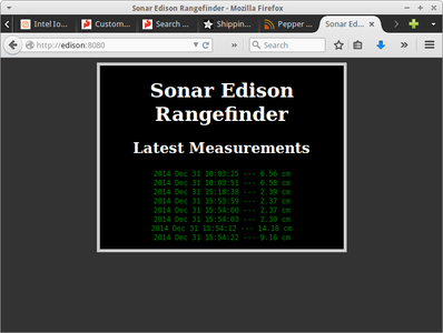

Step 3: Accessing Measurements From the Network
You can check the last stored measurements from your terminal with the following command:
root@edison:~# tail /tmp/arduino.log
We want however to be able to check our rangefinder measurements from our web browser (Isn't after all the Internet of Things what it's all about?)
So, create, type or copy and paste sonar_edison.js to a folder in your root home directory
(check https://www.instructables.com/id/Touch-me-Edison-ba... for some help)
and from this directory run node.js withsonar_edison.js
root@edison:~# node ./sonar_edison.js
You now have a web server listening at
http://youredisonaddress:8080/
that displays your latest distance measurements! Have fun!
