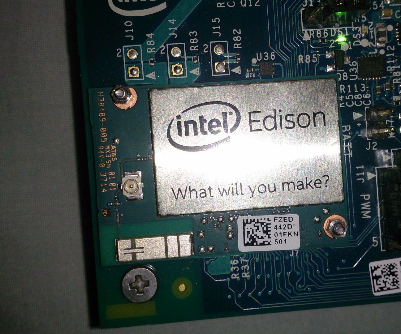

Step 1: Setup the Edison
Assemble the Edison with the Grove board. Place the buzzer on D4 and the accelerometer on I2C.
Step 2: Code
Copy the FallDetector.ino on to Edison and compile it. Now if there is a fall, the buzzer will go off.
