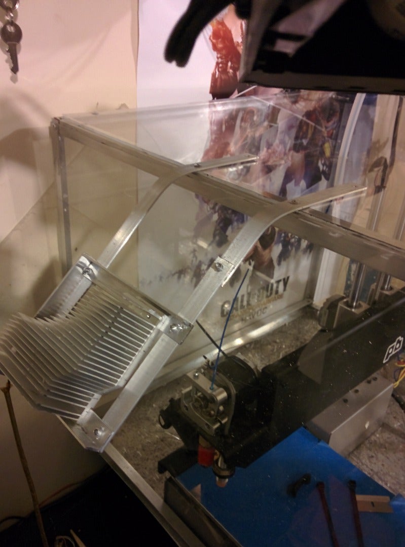

**// I have tested this to 50C and it is suitable like in this picture to print PLA, but NOT ABS! I will be updating this as I add improvements to print ABS. I was worried that the cold-zone on the hot end would require water cooling, but I contacted Brook and it shouldn't be a problem at 70C. So, I'm getting a better heater now. //**
I suggest using an Arduino, the Edison is still too Beta. It froze every single time!
From testing, I have discovered that the extruder itself will need cooling. The insulation worked too good! The printers heated bed is more than enough to heat this small of a box to way over 60C. It will print small prints, until the metal heats up to 50C (Brook mentioned something about but now I know what he meant).
So, I recommend making the box bigger. Don't worry version 2 is coming soon. Gathering parts now!

Let's add the front panel, door, and support frame for the door. The front is a 16'' x 20'' acrylic sheet with a 13'' x 10'' corner cut out. Cut another 16'' & 13'' pieces of aluminum for the door frame, and a 10'' x 13'' piece of acrylic for the door. Attach the 16'' piece in the middle of the vertical cut for the door and add the 13'' piece about 10'' on the 16'' piece (along the horizontal cut for the door). Everything was attached with rivets. The holes were made with a Dremel and drill. I positioned the hole for the door in the upper left corner of the front panel, about 5'' down the top of the left corner add the hinge. I used a small acrylic scrap for a spacer, between the hinge and frame. Now attach the 10'' x 13'' door I used a 2'' piece of flat aluminum for the hinge's rivets to brace against so I didn't crack the acrylic. I added a 3'' piece of angle aluminum at the top right corner for a spacer and added a hole for a pin to hold the door shut (I just used an unused rivet).

This part is really up to you. I used some scrap aluminum and acrylic to make a frame and mounted the boards to the acrylic pieces. Each board is mounted on it's own small piece of acrylic a little bigger than the boards. The hair dryer is mounted to another few scraps of aluminum and a few zip ties the hole for it was made with a Dremel. Hook up a small piece of wire, between the relay and the one screw terminal on the outlet. Now connect the power wire from the electrical cord to the other screw terminal on the relay. Hook up the ground wire to the other screw terminal of the outlet. Hook up the Grove Temperature Module to A0 on the Grove Shield.

Insulating to help hit 70C. Make sure you leave enough room for the full range of the printer's movements.
