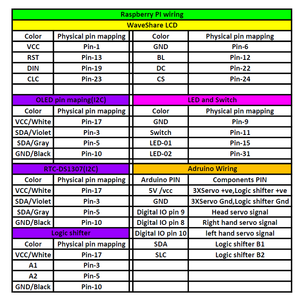

Step 2: Hardware Setup
To complete the wiring for this project, connect the following components: Raspberry Pi, Arduino Mega, 0.96" OLED display (I2C), DS1307 RTC module (I2C), push-button switch (connected to GPIO16), 3 servo motors (connected to Arduino), a logic level shifter (to safely connect 5V devices like Arduino and RTC to the 3.3V Pi), and the Waveshare 1.69" LCD module (SPI). Make sure I2C and SPI interfaces are enabled on your Raspberry Pi using sudo raspi-config. Use the logic level shifter between the Pi and any 5V I2C devices to avoid damaging the Pi. For the Waveshare LCD module, follow the wiring instructions and setup steps provided in the official Waveshare reference PDF carefully to make it work properly.
Also, connect your USB microphone to any of the Raspberry PI USB ports
