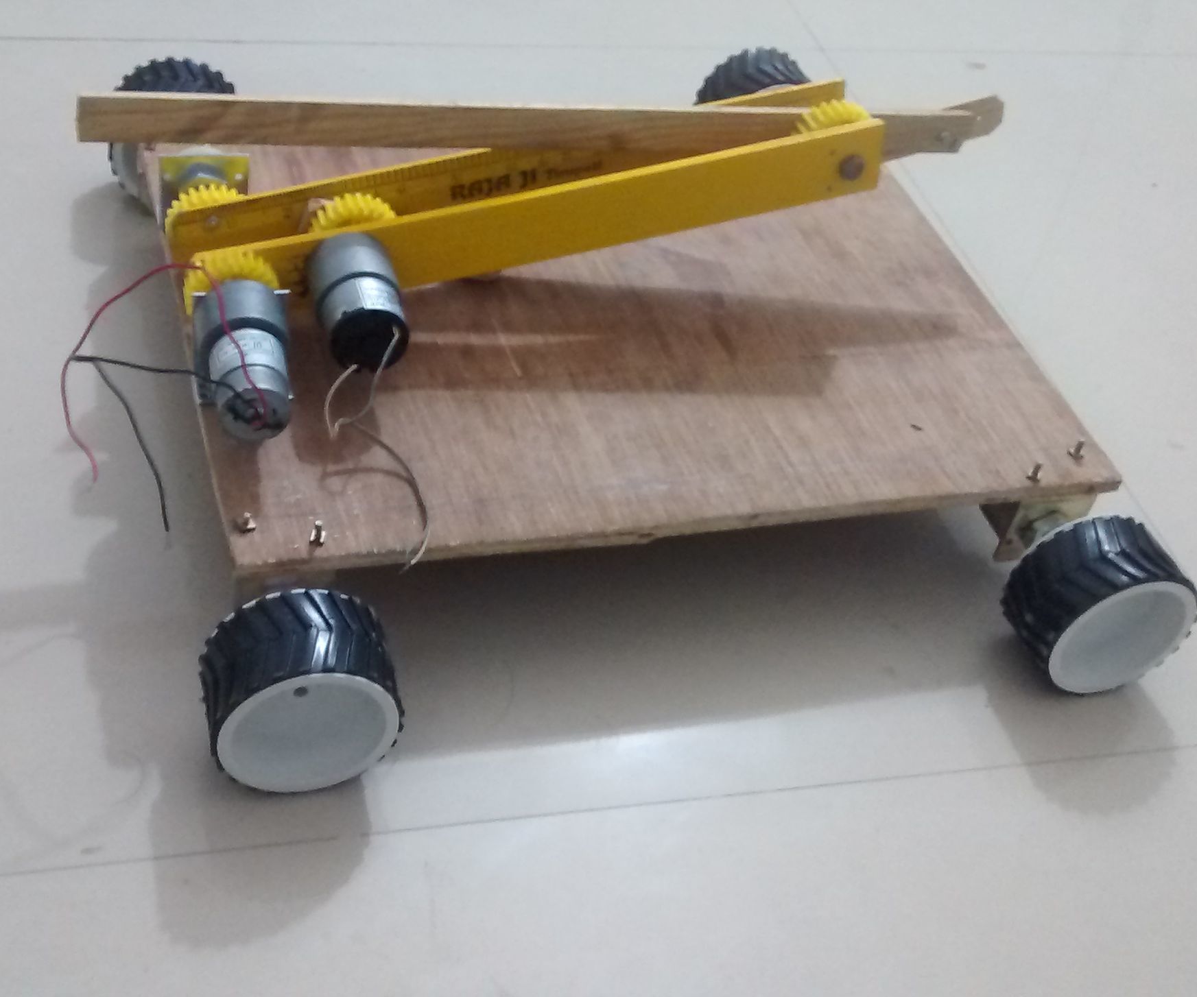

Take a plywood of 5mm or 7mm width and more than 50cm height. Cut it along as it is in fig 2 . Take measurement by calculations according to your wheels. Just remember the fact keep front wheel space more as we will design steering so calculate by moving wheels.Take a grinder and go on ....

We will use a 15 rpm dc gear motor to Control steering wheels but you can use Servo motors also. We will need
1.A gear hub
2.Two thin long plastic sheets or hard metal string
3.Two rubber stopper or plastic strips.
4. four long bolts that fits into the wheel axis properly
5.Thin and Small bolts or screws
6.Two 2cm x 7cm wheels
Rubber stopper can be the blocks of the wood as we are just creating a angular suspension to the front wheels. Just hole in them with drill and try to make a 90 degree L suspension for wheels as shown in fig no. 2, 3 ,and 4. Make hole equivalent to the Bolt in the car chassis as shown in the fig no. 5. Fix the wheel and Rubber stoppers to the chassis.Add a hole for the motor of slight larger equivalent to the neck of the motor in the center as shown in the fig. 6.
Fix the motor with gear hub . Make sure you shred gear head to plane by cutting of extra part for smooth steering.
Add two more small holes on the edges of the stoppers to fox the plastic strips and get along the Gear for movement.Calculate the length of plastic strips accordingly.Fix the small hole with screw or Thin bolts as you wish.See the fig no. 10 in the step. I hope you don't break the strips in the trial if so make necessary steps to stop extra movement.

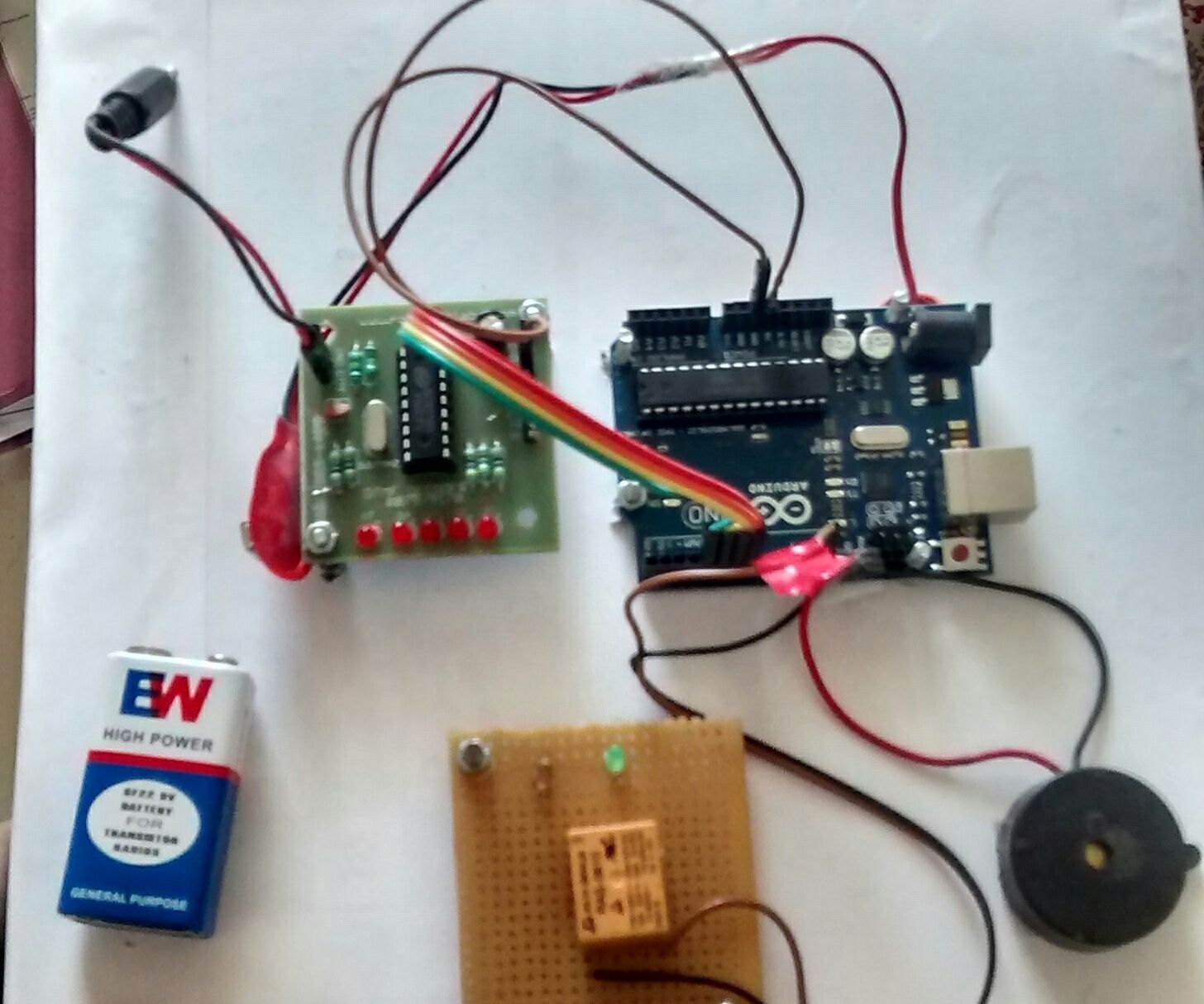

Hack a toy car - take out its wire from motor outputs from both the motors , battery unit and antenna wire(note * only a proper 5v operational, running(FWD and BCK) and steering(LEFT and RIGHT toy car only with good range).I got the one in fig 1. Add a 7805 5v Regulator assembly (Fig 2)to provide it a steady 5v supply. The FWD and BCK ie forward-backward motor wires is our inputA as you may have seen a input to the relay in concept picture of previous step in which we covered the understanding the concept part.(step 5 ).Connect a naked Relay or a Relay module to this motor as polarity doesn't matter here.The output of Relay will be same from the concept image.
Use a l293d motor driver module whose output will be connected to the 15 rpm steering motor and input given by LEFT and RIGHT RC kit outputs wire. shown in fig 3 of the step.Also test it to guaranty that RC remotes left is the steering motors left also.
Add a antenna to antenna wire.

Add 9v batteries to two 7805 regulators , a 9v battery with dc male plug to UNO, A 12v DC motor to the Relay according to concept picture.
