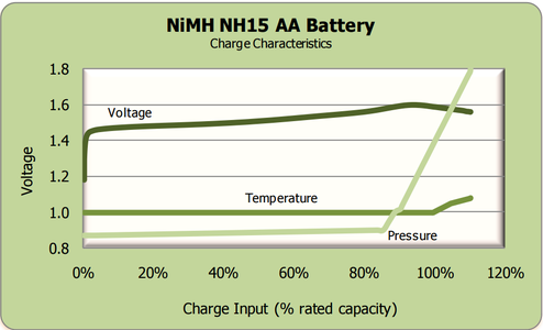

Some useful facts to remember that will help to understand needed parameters of charger.
C - current equal to nominal capacity of battery
When charged at the C rate single cell voltage may reach 1.6V. This voltage may be higher for old batteries.
Nominal voltage of single cell is 1.2V, but fully charged cell has an open-circuit voltage up to 1.5 volt.
Trickle charge rate of less than 0.025 C (C/40) is recommended after battery fully charged.
It is generally two options to charge NiMH battery:
1. Fast charging. Charging current 0.5C-1C. Charge state must be monitored and terminated by dV/dt (voltage change rate) or dT/dt (temperature change rate)
2. Slow charging. Charging current 0.1C. Charging time 14-16 hours. Charge termination by timer. dT/dt charge termination impossible for low currents. dV/dt termination may be not reliable for currents below 0.5C according to literature.
