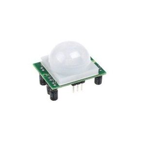

Passive infrared sensor (PIR sensor)

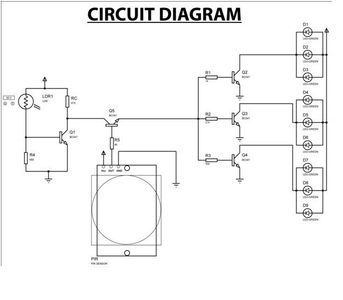

Step 2: Circuit Diagram
WORKING OF CIRCUIT
In this circuit, we need light at the output only when there is the presence of a man at the room and the intensity of light in the room is very low. For this, the output of LDR section and PIR section is applied to a transistor. Hence the further working of circuit will occure only when both the inputs of transistor are high.
When the intensity of light at the room become less, due to the high resistance of LDR, the vcc applied will pass through the collector terminal of transistor Q1. To the collector of transistor Q5. The output from PIR is applied to Q5 base. Emitter terminal output is applied to the control section, containing transistors. Each transistor is designed to work at different votages such as 1volt,3 volt, and 5 volt. When the transistor Q2 switch on, it will make the path for LEDs at its output to complete and hence it will make the LEDs to glow.
As the voltage from LDR section increases, AND gate output voltage also increases which will make transistors Q3 and Q4 switch ON and the output LEDs will glow correspondingly. Thus when the light is low, complete LEDs will glow and we get a higher light. As the light in the room increases, the circuit output light decreases as we needed.
