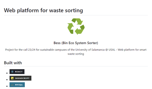

In addition, we have developed a specific web platform for recycling devices or machines, which allows real-time monitoring, remote management and collection of usage data. This platform facilitates the integration and control of the sorting machines, improving their efficiency and allowing a centralized management of the recycling system. All the code has been developed with React and Node to create the entire web platform and this code is free; you can find it at https://github.com/AnOrdinaryUsser/BESS_SAS.
