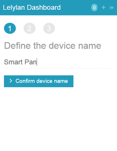

Open Lelylan Dashboard and create a new smart pan by following 3 simple steps (if you are new to Lelylan, you can sign up for free).
- Set a meaningful name (e.g. "smart pan").

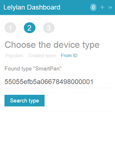

- Select the smart pan type. To do so, select the menu “from ID” on the top and use the ID 55055efb5a06678498000001 (a type defines what a device is by defining its properties, functions and statuses. Learn more on dev center).

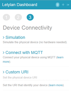

- Choose "Connect with MQTT" as connectivity option. In this tutorial we'll use MQTT, a lightweight publish subscribe protocol for the Internet of Things. At this point you can get the Device ID and Device Secret. Once the device is created, click the settings link (placed under the device name) and get the device ID and device secret. You'll need them in the next section to program the Intel Edison.

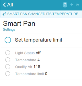

If you run successfully the code, you have already a full working IoT system!
Just connect to the lelylan dashboard (also from mobile) and see the values coming from your Edison.
