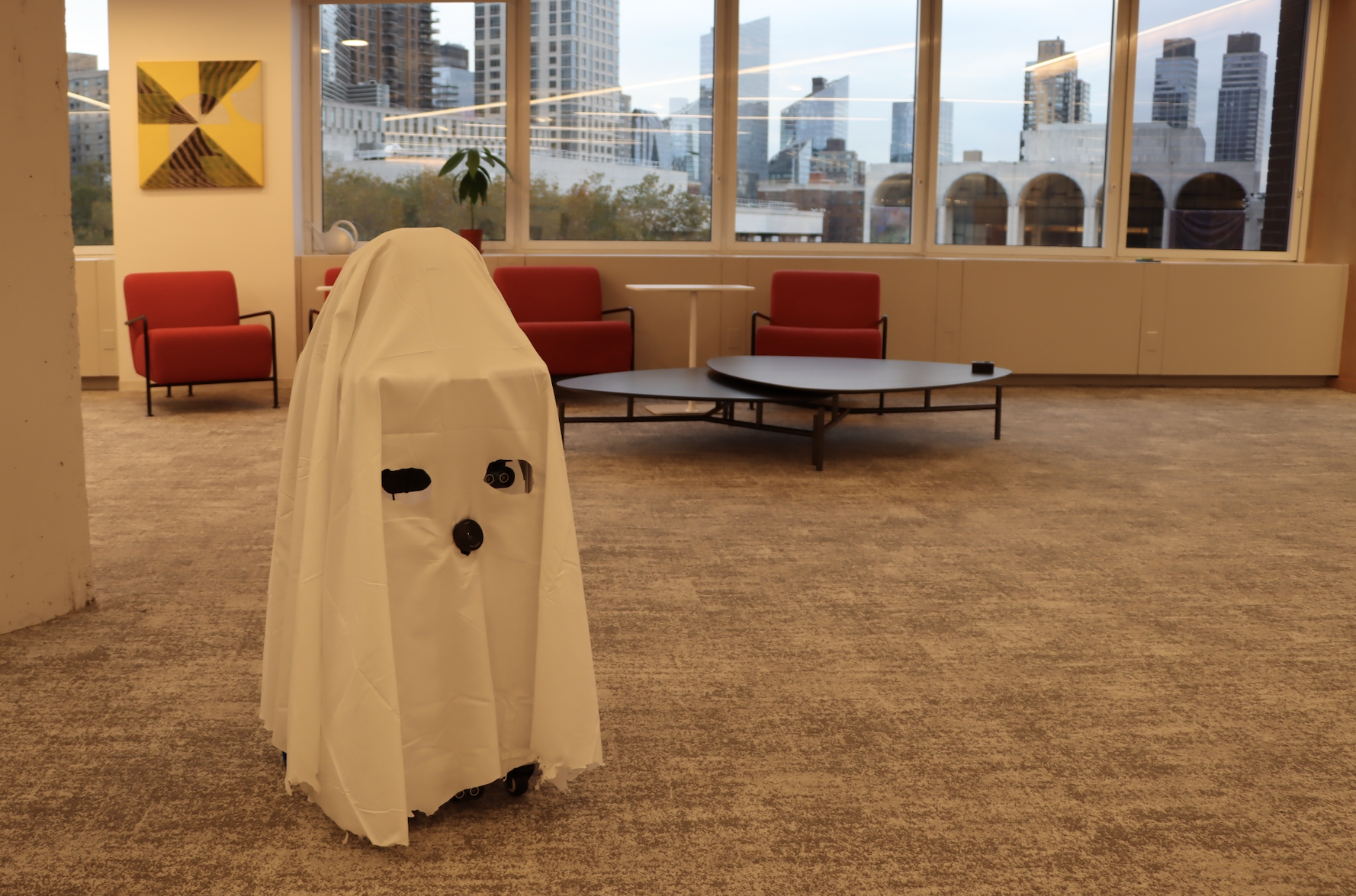

Now I was ready to test if I could push a button, take a photo, and print something corresponding to that. I initially got inspired by this Halloween project where they designed a Fear Photo Booth.
