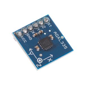

Step 1: Introducing the Accelerometer ADXL335
In this tutorial we are going to show how to use the library to display a ball and make it move around the screen using an accelerometer. The accelerometer that we will be using is the ADXL335.
This sensor measures acceleration, like the one due to gravity, on the x, y and z axes. Thus, if the sensor is at rest parallel to ground, only one of the axes will feel the acceleration of gravity. As you tilt the device, other axes will start feeling the acceleration of gravity too. This way, it is possible to analyze the way the device is moving.

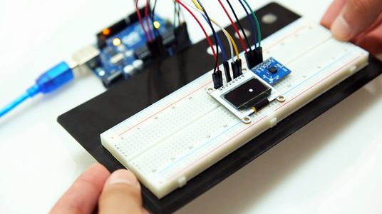

Step 2: Adding the Accelerometer to the OLED Set-up
So now that we know how the OLED and accelerometer work, it is now time to create our setup.
First we need to add the sensor to our OLED setup in the following way as shown in the image above.
The sensor’s pins are connected to the Arduino as shown below:
  • VCC – 5V
  • GND – GND
  • X – A3
  • Y – A2
  • Z and ST are left unwired
