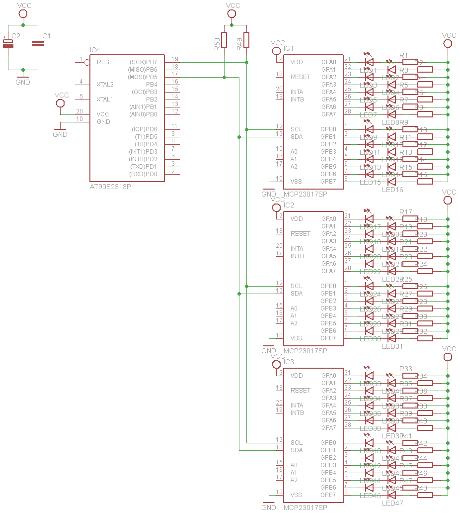

The microcontroller I used was an AVR ATtiny2313. These are rather cheap and I had a few lying around. ATtiny2313 also has one Universal Serial Interface and one USART interface that will come to good use in the following steps.
I also had three MCP23016 - I2C 16bit I/O port expander lying around, just the right count! I used each port expander to control one colour of the 16 LEDs.
The LEDs... Unfortunately, were the cheapest I could find. They are 48 red, green and blue ~10000mcd 5mm with 20 deg angle. This shouldn't matter for now, since this is only one prototype. Despite this fact, the result is quite nice!
I am running the microcontroller at 8 MHz. The I2C bus is clocked at 400 kHz. The LED switching frequency is about 400 Hz.
This way, if I am capable of driving 48 LEDs without pushing it to the limit, I'll room for more later!

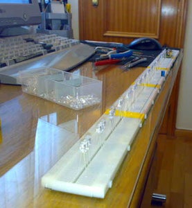

Step 3: Assembly
After several hours of cutting wires and assembling the circuit, I got this result:
One giant breadboard with 48 LEDs and tons of wire!

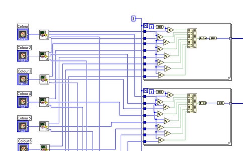

Step 5: Making It Easy!

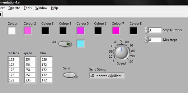

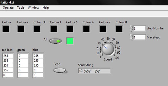

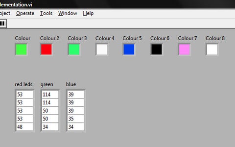

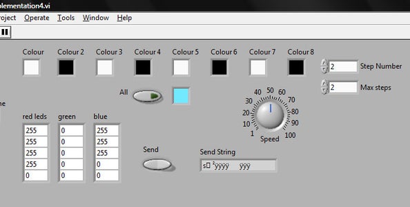

So I decided to make a program, where we tell the colours of each LED in one step of the sequence and we get the three arrays of the step.
I made this program in LabView due to time constraints.

In this program I am able to tell the microcontroller how long is the sequence, the colour of each LED and the time between steps of a sequence.
In the next video I'll demonstrate how I can change the colour of LEDs and define sequences.
