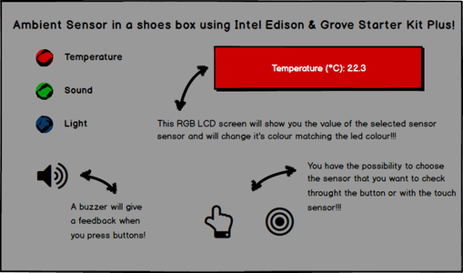

Hi i've seen a lot of Instructables here but i'd like to make a project where you can see the use of different sensors, buttons, buzzers, leds and lcd togheter!!! What we're going to realize is an INTERACTIVE AMBIENT SENSOR in which you can select what sensor check and every functional mode will have a different led and lcd colour!!!!
You can switch between the sensors with the button or with the touch sensor (you will see that the second will be "faster") and every time that you press the button or the touch sensor, the buzzer will give you a feedback and the proper led will switch on. The lcd display will have the colour of the led that is active and will give us information about the value of the sensor.

In the picture you can see the result of the project...i'm sure that you'll realize your sensor in a better esthetical way (and probably you'll find a better base then a shoes box), but you must understand that i can have this board only for few days and i've no time to realize a good shield for it :)
