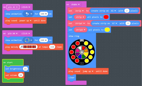

  3. To begin set the brightness and volume levels

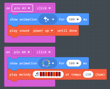

Then choose the wanted sounds and animations that will play with each touch

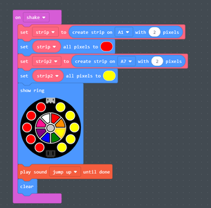

Step 3: Neo Pixel Lights
Set the color of the Neo Pixels and CPX that will activate upon shake
Step 4: Finished Code
This is how the code looks altogether
