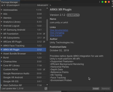

The first one will be AR Foundation.
To do so, click on windows, then package manager. Search for AR Foundation and click Install.
Then you'll need ARCore XR Pluginfor Android and/or ARKit XR Pluginfor IOS.
Search for them and install them.

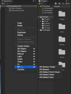

To add the AR camera you'll need to right click on the hierarchy, XR and click on AR Session. Do the same and add AR Session Origin.

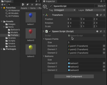

Save it and go back to Unity. Inside hierarchy, right click and choose Create Empty. Rename it SpawnScript and keep it selected.
Drag the SpawnScript code into the inspector section to add component.
You'll now find the two new arrays that you created just before because they are public.
Change the size of both array to 3.
To create the spawn points of the balloons, right click in hierarchy and create empty and name it point1.
Do the same two more times with names point2 and point3.
Inside your hierarchy, click on SpawnScript and drag your points one by one into your array.
Because all the three points are at the same position we need to make them appear at different places.
Click on each point and modify the Z axis by 1.5 for each point, then change also the X axis for point2 at 0.5 and point3 at -0.5.
The spawning points are ready but we need to add them the models that will be used, in this case we need to add the balloons.
Open Items folder in your assets and go to Prefabs, you should see your balloons.
Select SpawnScript in hierarchy and slide the balloons here.

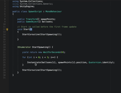

Update the code of SpawnScript with this script:
using System.Collections;
using System.Collections.Generic;
using UnityEngine;
public class SpawnScript : MonoBehaviour
    public Transform[] spawnPoints;
    public GameObject[] balloons;
    // Start is called before the first frame update
    void Start()
        StartCoroutine(StartSpawning());
    IEnumerator StartSpawning() {
        yield return new WaitForSeconds(4);
        for (int i = 0; i <3; i++) {
            Instantiate( balloons[i], spawnPoints[i].position, Quaternion.identity);
It spawns the three balloons at the points we prepared and will wait four seconds before spawning new balloons.

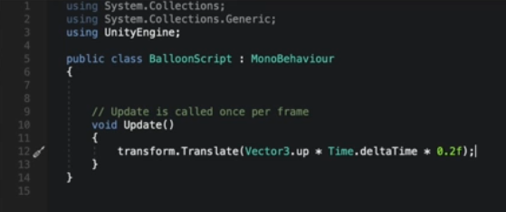

We need a new script for this, so create a new one named BalloonScript and type the following code:
using UnityEngine;
public class BalloonScript : MonoBehaviour
    // Update is called once per frame
    void Update()
        transform.Translate(Vector3.up * Time.deltaTime * 0.2f);
This will make your balloon move up by very small steps.

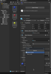

You now need to add this script to each model. Go to your assets Items, prefabs and click on the first balloon then in the inspector section click Add component and search your BalloonScript.
Do the same for the two others.

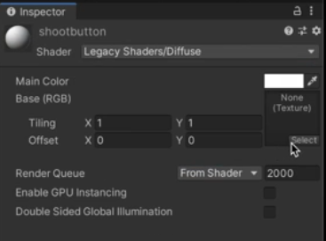

Go to your assets and open images. Create a new folder named Materials. Inside it create a new Material that you name ShootButton.
In the inspector change the shader by selecting Legacy Shaders then Diffuse.
Click on select and choose the shoot image.
Last click on Shaders again, UI and default.
Now create a new material for the crossbar and do the same but add the cross picture instead.
Now that the materials are ready, click on your button, change the Source Image in the inspector by none. Then click on Material and put your shoot button.

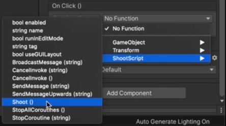

Now click on your button in the hierarchy and find the OnClick section. Click on add and drag the ShootScript from the hierarchy in it and then change No Function by ShootScript > Shoot()

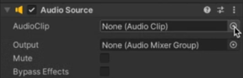

For the pop sound, go to your smoke asset, add component, audio source. Then click audio clip and add you balloon pop.
