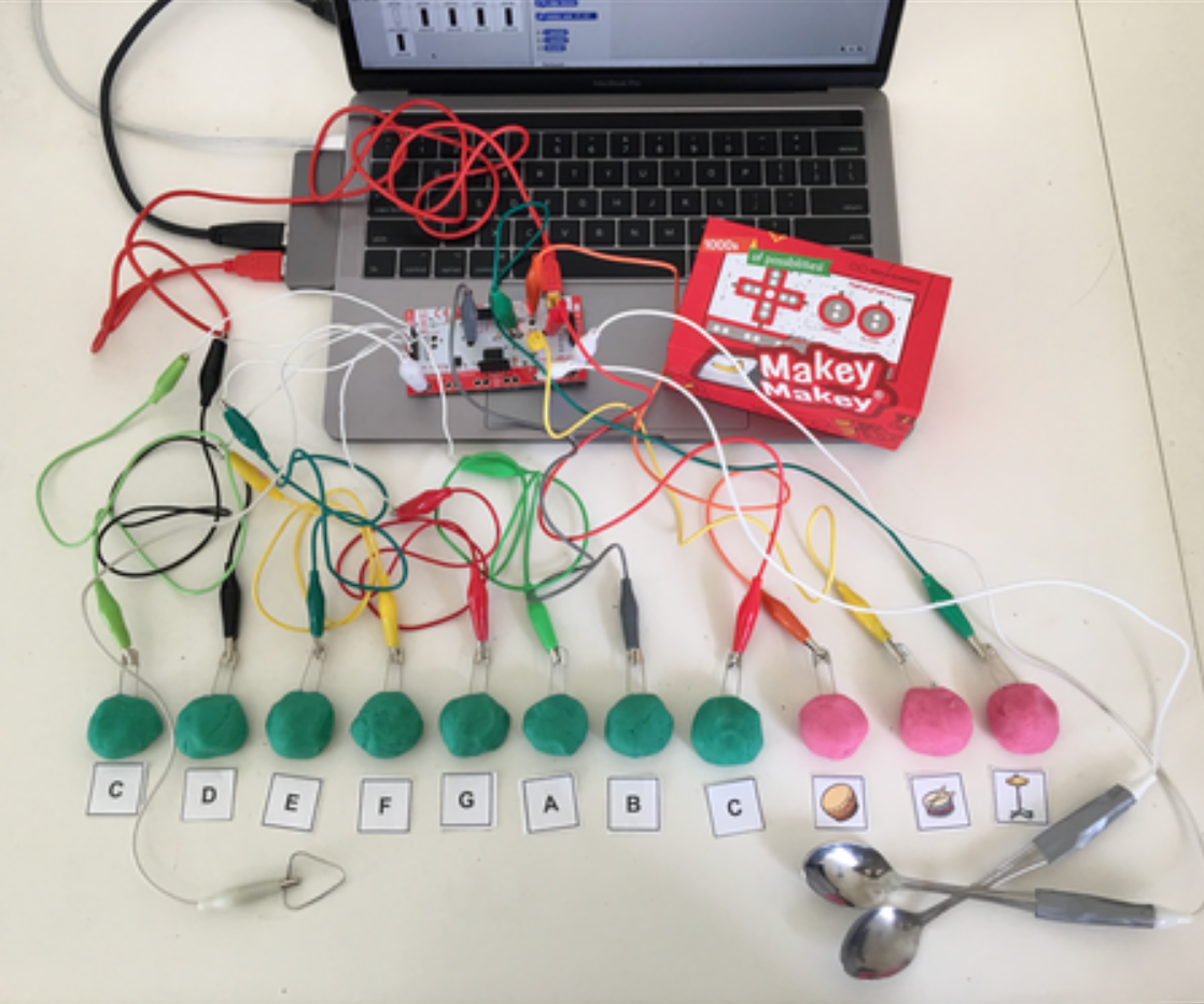

Step 5: Connect the Makey Makey
Connect the Makey Makey to the Treble Clef or Piano using the below key guide starting from left to right:
Middle C4 - W key
D4 - A key
E4 - S key
F4 - D key
G4 - F key
A4 - G key
B4 - Space
C5 - Left Arrow
D5 - Up Arrow
E5 - Down Arrow
F5 - Right Arrow
Connect the Makey Makey to the computer via the USB.
