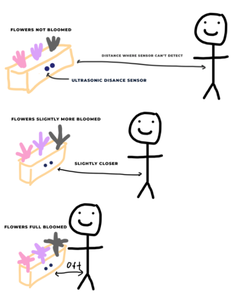

For the interactive portion, people will move towards and away from the flower box. Depending on the distance, the petals will bloom the closer you are or close the further you’re away.

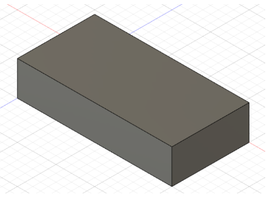

To attach the flower petals to the servo, we had to create different 3D models. The first one was to cover the already provided servo attachment. This way we can have other objects placed on the servo without damaging it. The servo attachment was around 1.4mm tall, 13.5mm long, base around 5.3mm and the tip at 4mm. Using Fusion360, we created a cap that will slide on the attachment. By using the dimensions, we created something 2mm bigger, this way the cap will cover the attachment nicely. Next, we had to create a petal attachment. The petals needed support and had to be glued on the servos, so using Fusion360 and the form tool, we created attachments that mimicked the petal shape. Finally, we needed a small connector that would connect the cap and petal together. A simple box would do. Having all of these let us connect the petals to the servos.
After 3D printing all of them, we hot glued them together. This fits onto the servo attachments nicely.
