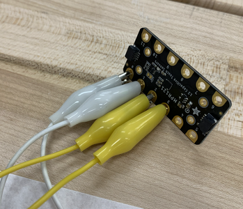

Step 3: Connect Wires to MPR121
Connect the alligator clips to your Adafruit MPR121 board.

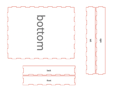

Step 5: Laser Cut Box
To make our box we went to makercase.com
This website gives many options for different boxes that can be laser cut and assembled through the use of finger joints (no glue/adhesives needed).
A picture is attached to show an example of what your laser cut model might look like.
There is also a picture of the assembled box to show what the finished product should look like.
Optional: We cut two extra pieces of wood, and glued them to the top and bottom of the box to secure the menu in place. You can see this in the attached pictures.
