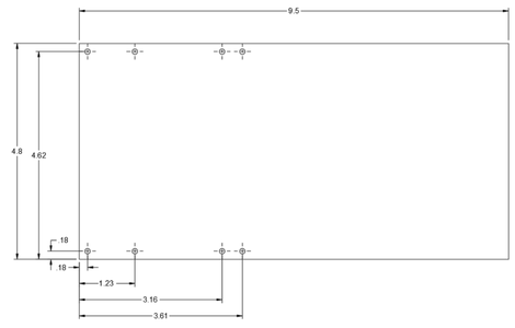

Step 2: Create Acrylic Plate
  1. Cut out an acrylic plate with dimensions 9.5” x 4.8” x 0.0625” (1/16" thickness)
  2. Follow the drawing below to drill out the holes.
If you have access to a CNC machine, you can use the DXF file linked in step 1 to make these holes as well.

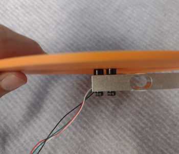

Step 4: Create Load Cell Apparatus
  1. Build the load sensor apparatus and attach it to the bottom of the cauldron. Use M4 nuts and bolts with 1/4" and 1/2" spacers. Note that spacers must be used to raise up the load cell to get accurate scale readings!
Note: We took the acrylic plate off the load cell in the second image to better show what the hardware looks like. The finished product should have the plate covering the load cell.

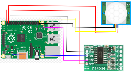

Step 6: Wire the Load Cell and PIR to the Raspberry Pi
  1. Follow the wiring diagram above to connect the F-F jumper wires from the PIR and the load cell to the Raspberry Pi. For reference:
  2. Both VCC (red) wires need to go to 5V
  3. GND (black) can go to any Ground on the Raspberry Pi.
  4. PIR DOUT goes to GPIO21 (yellow)
  5. HX711 SCK goes to GPIO26 (pink)
  6. HX711 DT goes to GPIO4 (blue)

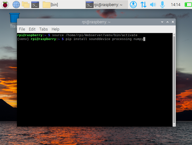

Step 10: Download Environment Packages
  1. In the terminal, activate the virtual environment with “source ~/Webserver/venv/bin/activate”
  2. In the terminal, type (without quotation marks):
  3. “pip install sounddevice processing numpy”
  4. “deactivate”

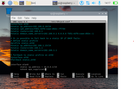

Step 11: Setting Up Access Point
  1. "sudo nano /etc/dhcpcd.conf"
  2. add the following to the bottom:
interface wlan0
static ip_address=10.0.0.1/24
nohook wpa_supplicant
  1. Ctrl + O, Enter, Ctrl + X
  2. "sudo service dhcpcd restart"

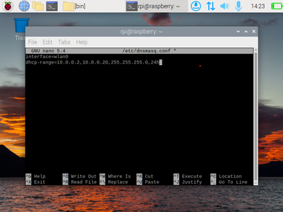

  3. "sudo mv /etc/dnsmasq.conf /etc/dnsmasq.conf.orig"
  4. "sudo nano /etc/dnsmasq.conf"
  5. Add the following:
interface=wlan0
dhcp-range=10.0.0.2,10.0.0.20,255.255.255.0,24h

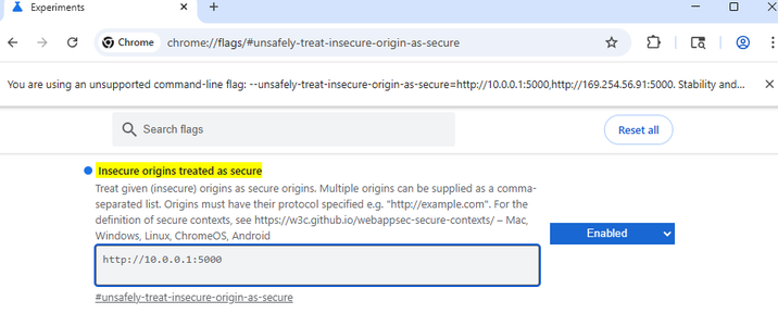

Step 15: Connecting to the Pi Remotely
  1. Connect to the Pi's network, "CauldronNetwork"
  2. password is "cauldronadmin"
  3. Use google chrome on a separate device
  4. Goto "chrome://flags/#unsafely-treat-insecure-origin-as-secure"
  5. Add the Pi's ip to the box below (http://10.0.0.1:5000) and enable the flag
  6. Restart chrome and open http://10.0.0.1:5000
  7. Ip may be different depending on your config. Check the ip by hovering your mouse over the top right corner with the ↑↓
  8. Website will always be hosted on port 5000, so visit the website at https://YOUR_IP:5000.
  9. To properly initialize (autonomous mode), enable and disable microphone once upon startup
  10. Use headphones, and keep device away from pumpkin microphone to prevent feedback loop
