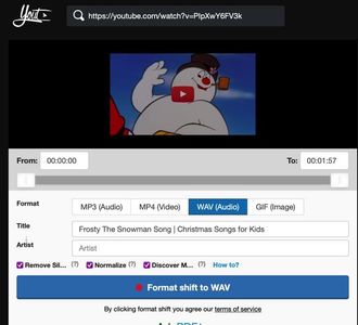

I downloaded audio versions of YouTube videos, one of "Frosty the Snowman Song | Christmas Songs for Kids" and one of "Santa Claus is coming to town". The method I used is:
  • Go to your chosen YouTube video
  • in the url, change "youtube" to "yout"
  • Download as a .WAV File
  • Download the free audio editor "Audacity": https://www.audacityteam.org/download/mac/
  • Edit the files as desired, and export them as .wav files with 22kilohertz and 16 bits per sample.
  • I put the files in a folder called "holiday_sounds", and I recommend using the same name because you won't have to change any code later on
  • Copy the "holiday_sounds" folder over to your Arduino

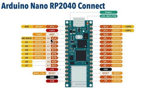

After you've seen that, set up the board according to the picture and diagram above. The Strip signal goes to D2, the power goes to VIN, and the ground goes to GND. For the speaker, use one alligator clip/male pin from GND and go to the base of the cord, and one alligator clip/male pin from D3. Finally, use one alligator clip/male pin from GND to the base of the metal at the end of the switch, and one from D5 to the tip of the metal at the end of the switch.
