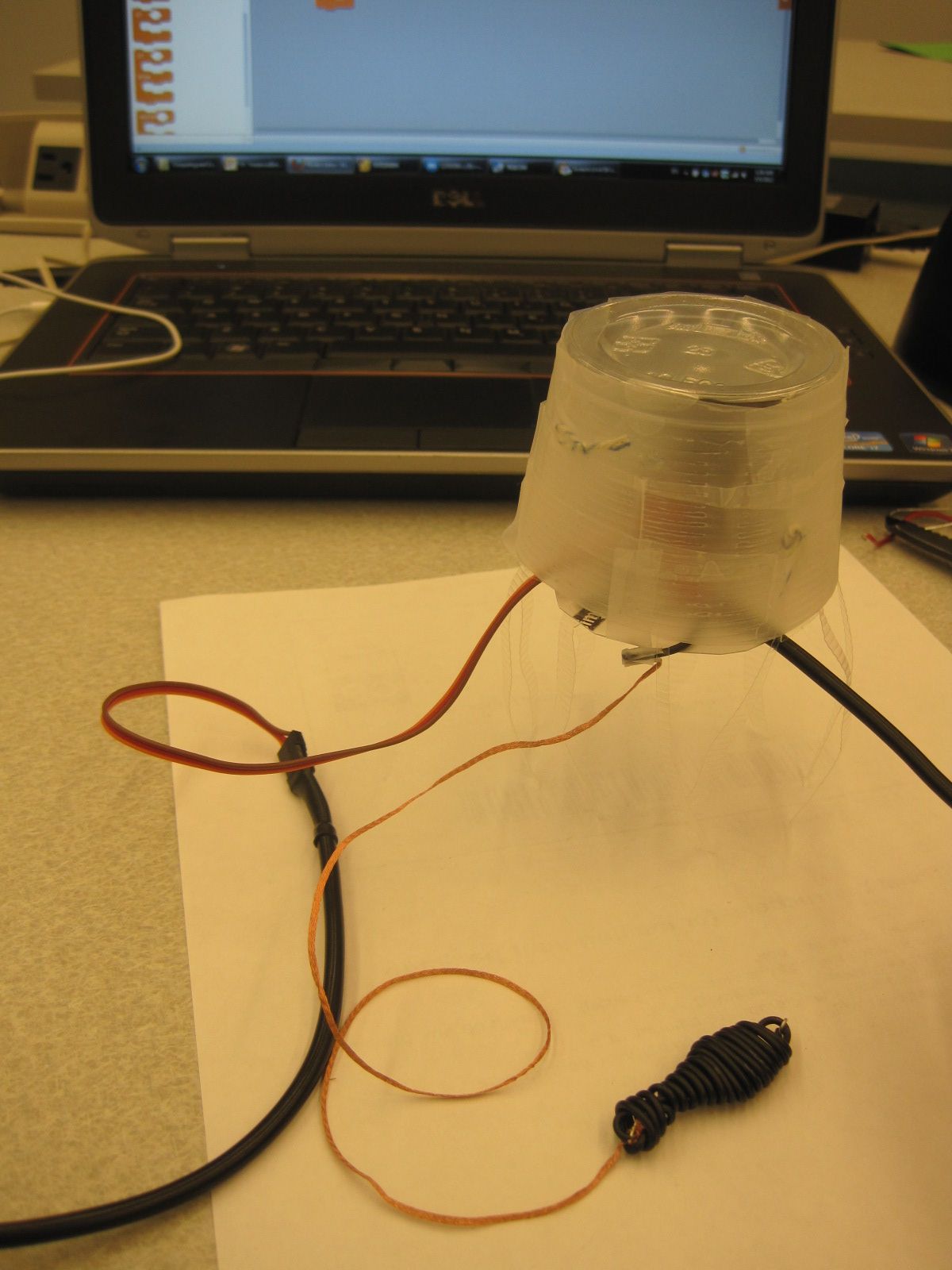

Step 7:
For cup 1, you need a bigger opaque cup and several smaller transparent cups (that you can put the smaller ones in the big one). Attach the LED and the photocell light sensor to the inside of the opaque cup, one on each side (as shown in the picture. Do this before you solder the light sensor and the LED to the circuits!). So when you put the transparent cups with different liquid in the opaque cup, the light sensor can sense the difference in the amount of photons that go through the liquid, depending on the difference of transmittance.
Step 8:
For cup 2, you need a light heat-conducting cup and a base (which was made from a slightly bigger cup) that the cup can stand in. Mix the Thermochromic paint with the fabric paint, apply evenly on the surface of both the cup and the base. After the paint dry out, make two parallel holes on the “wall” about 0.5 inches away from the bottom, each on one side of the base. Put the bendy sensor through the base via the two holes. Now you can put the cup in the base (on the bendy sensor). So the bendy sensor bends when you add water to the cup, and speed up the music. Also, the cup will change color following the change in temperature, due to the thermochromism paint.
Step 9:
Attach two cups and the speaker on top of the base (the box), and hide all the electrical component in the box, except for the light ambient sensor.
The picture shows how it looks from the back.
