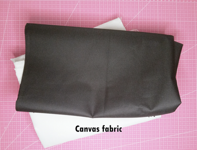

  • Canvas fabric:
  • White
  • Black

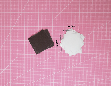

Step 2: Cutting Squares
Supplies used: Measuring tape, marker, scissors.
In this step, we will cut squares of 6 cm x 6 cm.
About 36 squares for each color of fabric. In total there will be about 72 squares of fabric.
These squares need to be 6 cm x 6 cm, because the idea is to get squares of 4 cm x 4 cm once sewn, and to have a square of 4 cm x 4 cm with a 1 cm margin, we will need squares of 6 cm x 6 cm.
With the help of a measuring tape and scissors, we cut the two pieces of fabric.

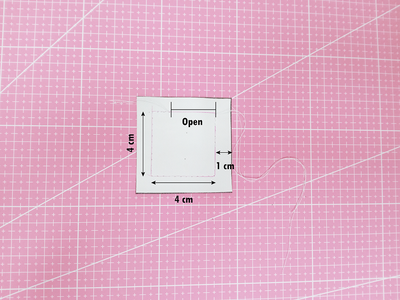

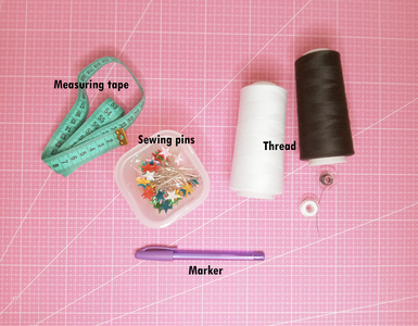

Step 3: Sewing Squares
Supplies used: Measuring tape, marker, thread, sewing machine.
In this step, we will sew the squares cut from the previous step, for them we need:
  • Two square pieces of 6 x 6 cm; one in white and one in black.
We will place the squares together on the right side of each fabric.
Remember to leave an opening in the seam; this opening will help us to turn to the correct side of the fabric.
We sew an internal square, leaving a margin of 1 cm, this will give us a seam of a square of 4 cm x 4 cm.
We can cut the corners of the seams, to make it easier to turn the fabric over.

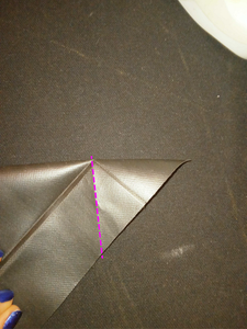

We are going to make a fabric board of 40 cm x40 cm, and 4 cm of seam allowance.
  • Cut a square of fabric 48 cm x 48 cm.
  • Mark 4 cm on all sides of the square.
  • Fold and iron the marked seam allowances.
  • Joining the corner stitches, iron again.
  • Turn the fabric over and sew along the corner mark.
  • Cut off excess fabric.
  • Turn the corner over.
  • Sew a 3.5 cm seam allowance

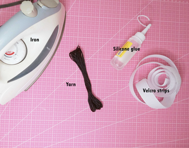

Step 6: Gluing Velcro Strips
Supplies used: Silicone glue, velcro strips.
In this step with the velcro strips:
  • We will cut a square piece and glue it behind each square of fabric.
  • We will also cut 6 velcro strips that we will glue in the center of the fabric board; for this we will make an inner square of about 24 cm x 24 cm on the 40 cm x 40 cm fabric board. These strips are the ones that will hold the removable square pieces.

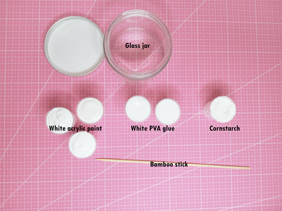

Step 7: Making Gesso
Supplies used: White acrylic paint, white PVA glue, cornstarch, glass jar, bamboo stick.
In this step, we proceed to make a homemade gesso mixture.
The gesso is a mixture that is placed before the painting, to make an even and impermeable layer that will make that any painting that we put on it, conserves its color characteristics.
For that, we will use the following measurements:
  • 3 parts of white acrylic paint
  • 2 parts of white glue
  • 1 part corn starch
Pour the ingredients in a glass container with a lid, and stir with the help of a bamboo stick.
Once the ingredients are incorporated into a homogeneous mixture, you can use this gesso.
