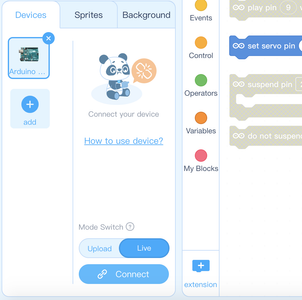

This step connects our Arduino to the mBlock software so it can interact directly.
Download and install mBlock V5.4.0.
Then, connect Arduino Uno with Proximity Sensor to your laptop/computer.

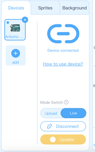

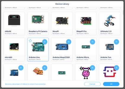

On Devices tab click +add, and click OK.
Choose LIVE, click Connect and tick “Show all connectable devices”, choose highlighted device (eg. COM…in Windows, or dev/tty.usb.… in Mac)

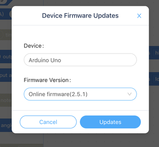

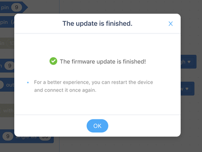

After that, choose Update, Update Firmware then click OK, and try to connect once again.
After “Connected”, you’re ready to the next step.

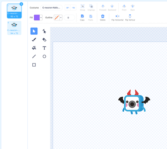

From Sprite tab delete Panda, then click + (add), choose sprite with multiple costumes (for animation effect) or you can to draw your Sprite with clicking Paint icon.
You also need to draw Stalagmite and Stalactite with multiple costumes, check screenshots above, then you have to edit/draw for cave Backdrop.

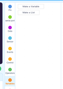

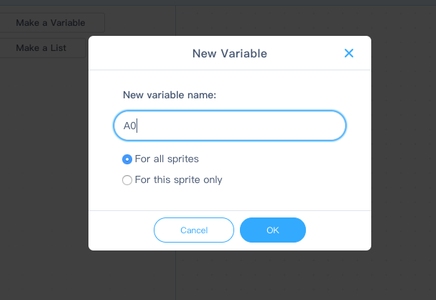

Here we will start by knowing the value of the Proximity/Distance Sensor installed at A0, then we will create a variable A0
Then create a series of block code as seen in screenshots above.
And run it by clicking on the flag icon. So on the left screen the value A0 will appear when we move our hand in front of the sensor (in my case the value range is 240 - 600), so we will use this as input where the output is the Y coordinate which value is 180 to negative 180 as shown in grid image above.
Then, create other variables: y, Score, dan Live.

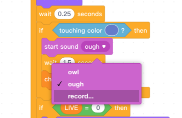

Then follow block codes for Bat and Stalag:

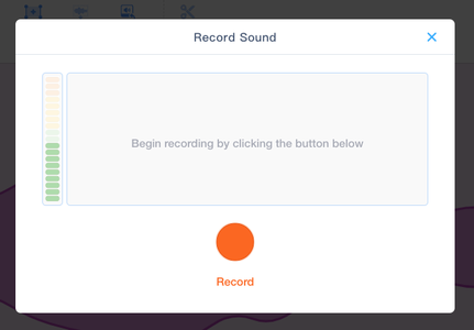

In these two block codes, you can add a sound effect of bumping (ough) in the Bat block as well as add music in the Stalag block.

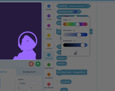

To complete the “touching color” in the Bat block code, you need to choose the Stalag color by directing it to the sprite.

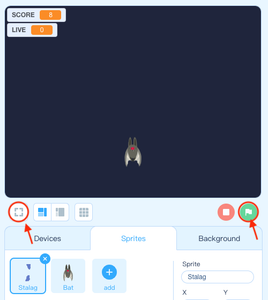

Click on the fullscreen icon and on the flag to get started. Move your hand to control.
Yay, It works!
