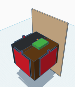

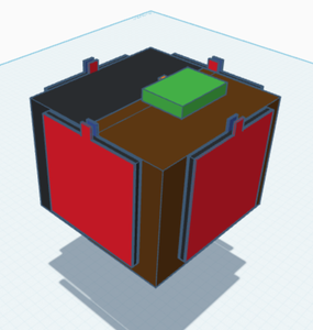

I have determined that the placing copper based FSR sensors over the antennas would reduce the antenna zone down almost to zero. Thus making a hole inside the FSR sensor, placing an antenna there and protecting it with eg. thick HD-EVA foam could be a great solution.
All of the 4 antenna placed in the middle of FSR squares are to be wired at the top of the machine, best if protected with a plastic box.
