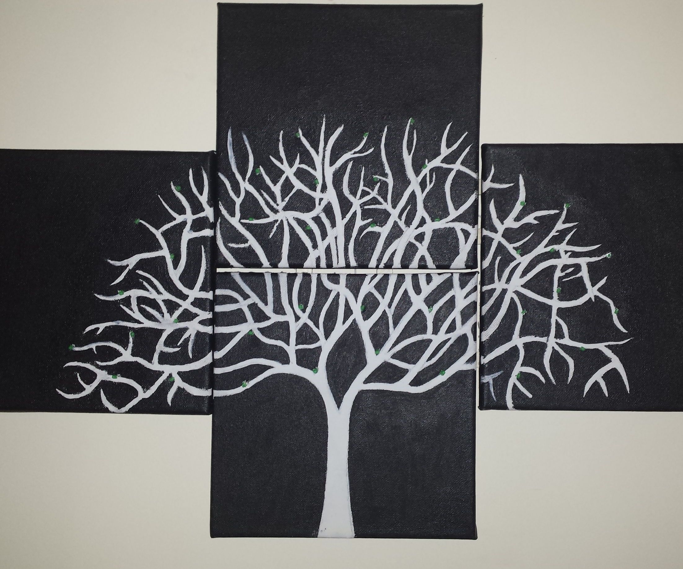

Step 4: Building
Step 1.
Select where the LEDs will be coming through the canvas and cut + shapes with a scalpel in those places. Remember the holes for the two IR LEDs and the Sensor. I placed them at the bottom of the canvas.
Step 2.
Get a piece of cardboard (i used a piece from a rigid envelope) and lay the canvas with the holes face down on it. Proceed to mark where the holes are on the cardboard by pushing a pencil through the holes and drawing on the cardboard.
Step 3.
Cut holes in the cardboard where the markings are.
Step 4.
Push LEDs through the holes in the cardboard and orientate them so all the anodes are pointing in the same direction.
Step 5.
Wire all the LEDs in parallel with 300ohm resistors between the anode and the 9V supply. Then wire all the cathode pins together. Wire the 1Mohm resistor to the anode of the Photodiode and wire the anodes of the IR LEDs together and the cathodes of the IR LEDs together. Also, solder the resistors in the correct configuration to the transistor base and connect its collector pin to the cathode of one of the LEDs.
Step 6.
Remve the components from the cardboard and push them through the holes in the canvas. Repeat for each canvas if you have multiple
Step 7.
If you have multiple canvas' (like me), fix the canvas' together by some means, i used thin pieces of wood nailed into the frame (shown in the picture).
Step 8.
Wire the canvas' together. The anodes of the white LEDs need to be connected together and the common ground needs to be created from the emitter of the transistor. This ground also needs to be connected to the Photodiode and the cathode of the IR LEDs.
Step 9.
Choose a position for the Microcontroller to sit in the canvas frame. Solder wires to the base resistor of the transistors, to the anode of the IR LEDs and to the anode pin of the Photodiode (not after the resistor, before),making sure that the wires can reach the relevant pins on the Arduino.
Step 10.
Connect the wires to the relative Arduino pins (tip: label the wires when you connect them) and connect the battery clip to the 9V line and ground. Make sure to connect a 9V wire and ground wire to the Arduino via the Vin or Vcc pin and GND pin respectively.

Step 5: Final Product
Here it is and here's the video of it working. The battery holder with switch broke so i had to resort to a simple clip where i have to remove the battery to turn it off.
There is two codes attached, game 1 and game 2. Game 1 has one game programmed in which is the reaction game. Game 2 has 2 game, the reaction game and a memory game.
